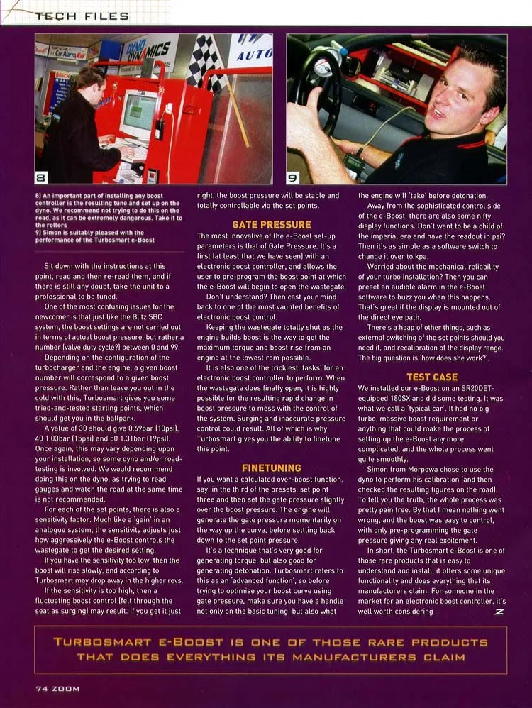

Almost done with my custom set-up (so excited). I just can't seem to set my turbosmart properly. What I'm finding is that whatever setting I make on SP1, 2 or 3 (i.e 5psi) does not correspond with the actual boost reading. My boost often spikes past the seting. Any suggestions?
Doesnt the setting is for percentages, and not for an actual psi reading?

Found the article, here it is....read the first few paragraphs.

This guage actually displays "live" boost settings, it's quite nice but a little complicated to learn at first. I bought this unit as part of a used turbo kit sale. I don't know how much it retails for, but I give it a thumbs up so far.
