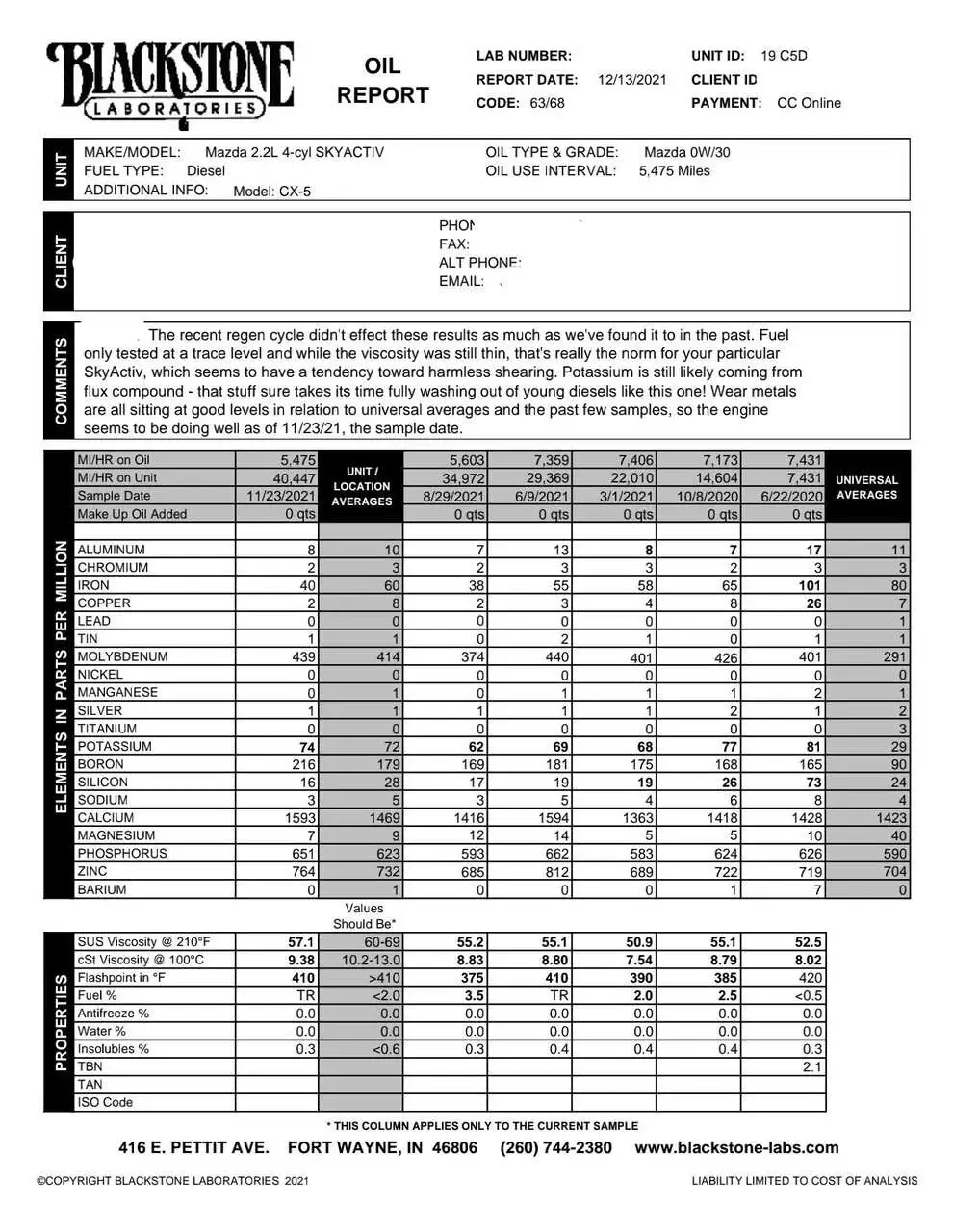

I don't have a dog in this hunt but here's UOA from brand new to 40k miles to illustrate the "wear metals" present in oil (parts per million) for mine.
Not much difference first oil change to second.

Your oil analysis shows elevated Iron, copper and aluminum at your first oil change, 2x to 12x the 40k readings. Those are wear products from the engine.
Yes, that is correct. So, added all together (the metals) were 151 parts per MILLION (first oil change) versus 76 parts per MILLION on the fourth (30k mi service). Yes, the number is 2x the parts per MILLION. So instead of one spec of metal there are two specs of metal. Or to put it another way, if you think of a fully loaded 747 full of crew, 400 passengers, 700 carry on's, 300 checked bags, cargo and 50,000 gallons of fuel weighing a total of one million pounds. The difference is one checked bag versus two checked bags out of the whole plane. Not much difference as far as being worried to get that "break in oil" out of the engine early. (IMHO)

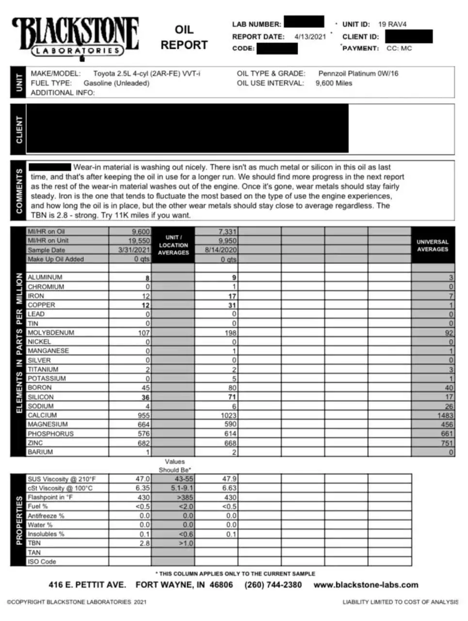

I did an oil change early on my ‘19 gas RAV4. I did it at 2500 miles and did the next change at 10000 miles. I did a used oil analysis at 10000 miles and the results were somewhat surprising. Wear metals were still elevated some so the engine wasn’t done breaking in yet at 2500 miles. My next oil change at 20000 miles showed normal wear metal levels (prescribed OCI on that generation is 10k miles btw). Not a SkyActiv engine, but interesting nonetheless. When I traded it in for my ‘21 RAV4 Hybrid, I used that data to decide to do my first oil change at 5000 miles as 2500 miles may not be through break in yet.

Here is mine as well from the ‘19 RAV4, just a smaller snapshot (2500 to 10000 miles, and 10000 to 20000 miles). No UOA for what the factory fill was.
Did the earlier than prescribed oil change save me wear and tear? I honestly doubt it. It was fun to do anyway. Just stick to the service schedule and you’ll be fine.
