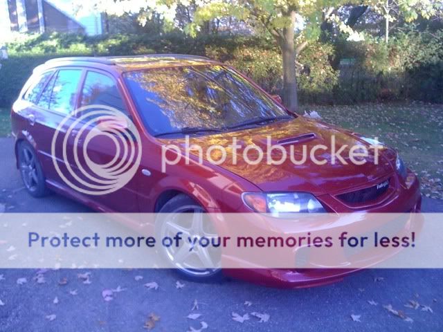

Sedan Headlights in a P5
Sedan headlight on P5.
Remove corner light on the bumper of P5 gives a better result

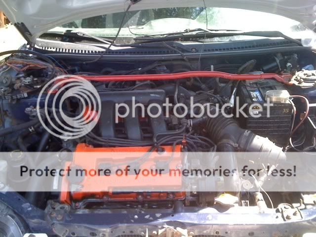

Spec: Mazda Proteg5 Bagless
Engine: Mazda KLZE V6 200Hp
Radiator: Volk Golf GTI 2004
Transmission: Manual Mazda MX6
Headers, lighten flywheel 14.4 lbs, Ceramic Clutch Centerforce Dual Action
Dual Exhaust Dodge Neon 2005 0 change catalyst
