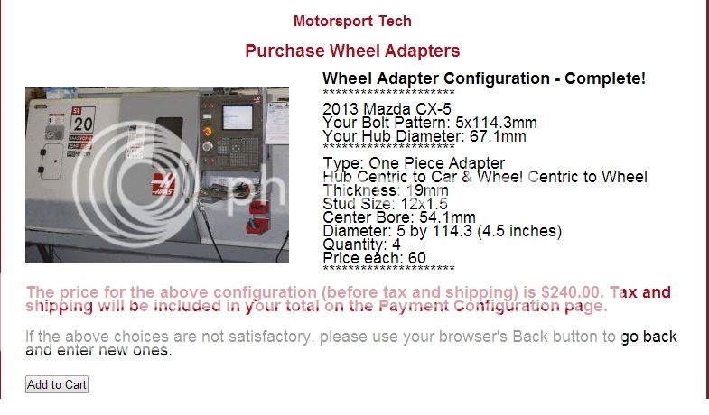

u could get a wheel adapter to make them fit for around $240 but for that cost might as well just get aftermarket wheels
