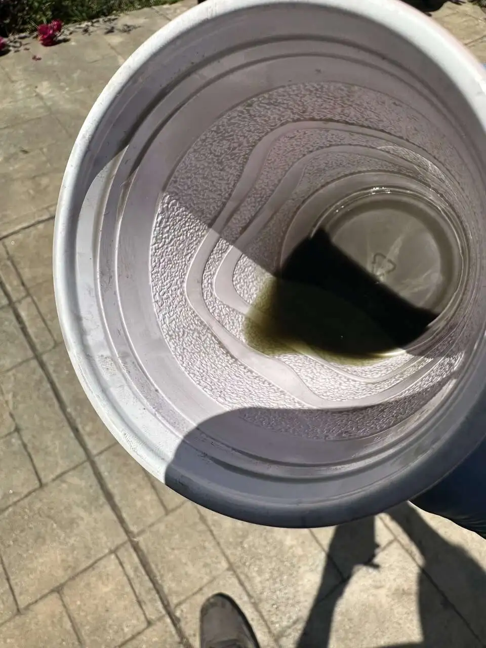

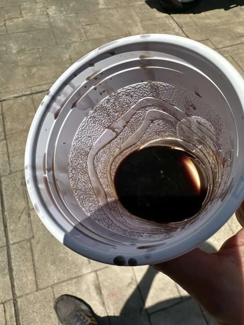

Trans au jus, probably the first time it’s been changed on this neglected car. I’ve only owned it a few months and discovered how much love it needed.
Car is 2014 with 75k. First pic is the final drippings of 4qts drained, second picture is after running 4oz of fresh fz new through. Very dirty for 75k ‘lifetime’ fluid.
Thought this might be useful to someone.
Did you happen to save any for used oil analysis? Mine looked just as dark at 50 and 100k on my ‘13 CX-5, but thankfully wear metals were extremely low. Blackstone doesn’t provide a particle count though.
Are you going to do another drain/fill or 2? I’ve been doing 3 drain and fills for each fluid service. Another 4+ quarts of fluid remain in the torque converter so multiple drain and fills are required to try and replace as much ATF as possible. You’ll see the fluid draining looking more blue with each drain and fill.
I’ll do a couple more d&f’s then a filter change. I still have the used oil but not planning to have it analyzed.

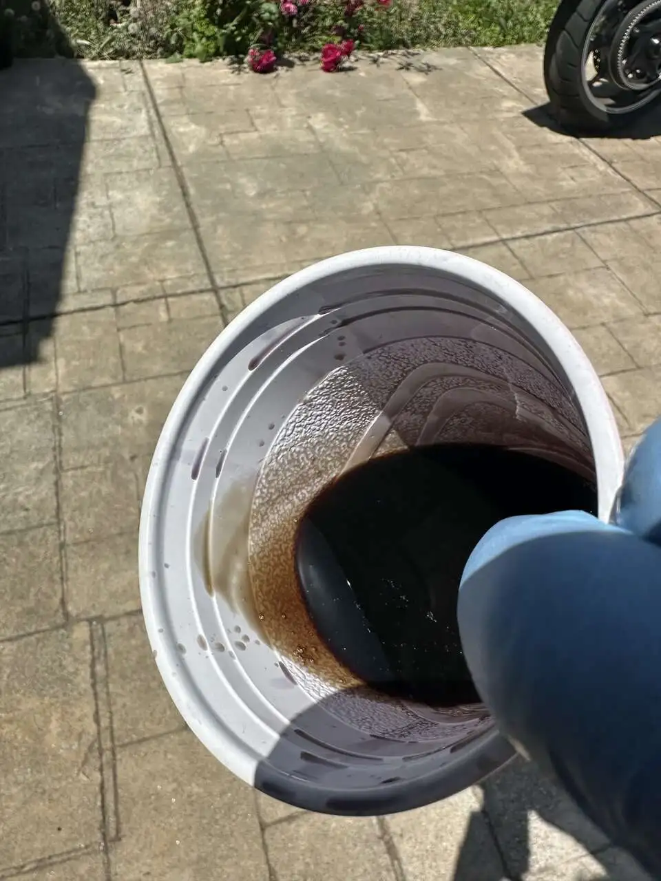

Second drain and fill drippings after rinsing 6oz fresh fluid through. Starting to take on a little more of the greenish hue of the Aisin FZ im using. Maybe one more d&f before a pan drop/filter change. Still surprisingly brown in my opinion.

Second drain and fill drippings after rinsing 6oz fresh fluid through. Starting to take on a little more of the greenish hue of the Aisin FZ im using. Maybe one more d&f before a pan drop/filter change. Still surprisingly brown in my opinion.View attachment 319829
If you’re driving in-between fluid changes or cycling the transmission while the car is running, you should be good to drain and fill one last time while dropping the pan at the same time. Expect to use an extra quart or so refilling after dropping the pan as you’ll get slightly more out during the process.
