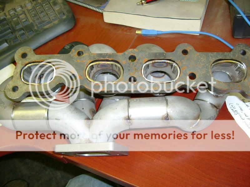

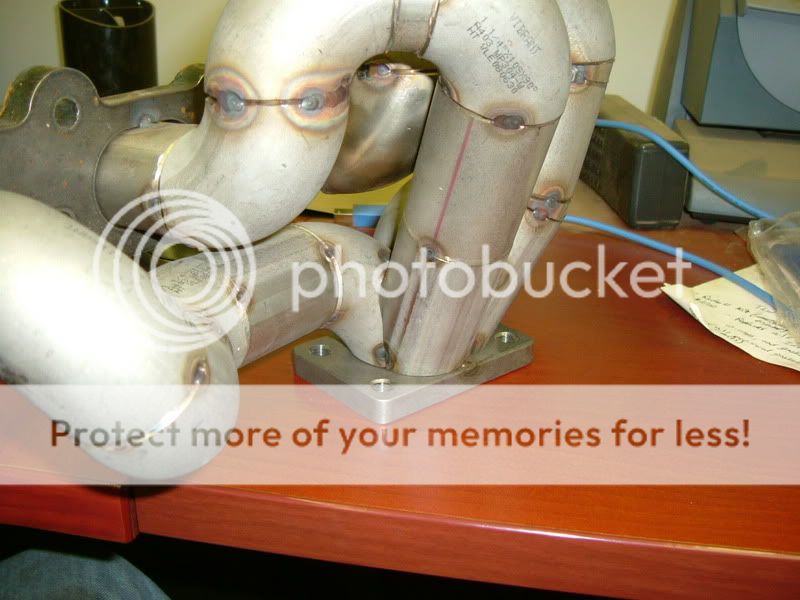

Do you have any pictures from the inside of the turbo flange? Is it a 4-1 style collector or are the runner tubes just jammed together at the flange?

If you go to the TO forum you can get more info and a good look at the collector of this manifold. Meh...this link will probably get deleted or mangled but oh well. http://www.toprotege.com/forums/showthread.php?t=36458
Personally I think the MAM mani looks better, but that doesn't mean anything (to me) if this one performs better. Good luck with your manifold, be sure to post the dyno results.
The pictures of the collector from the TO Protege site and the ones posted on the first page are not the same. The rear runners seem to just flow right into the flange and not have a collector.
100% Definately not the same...Different angle on the rearsfor sure.
I am sure he changed the design..It looks like originally he wanted it to all come in from the top..but then I am sure the reality of space imitations quickly set in...so It had to come from a different angle.
