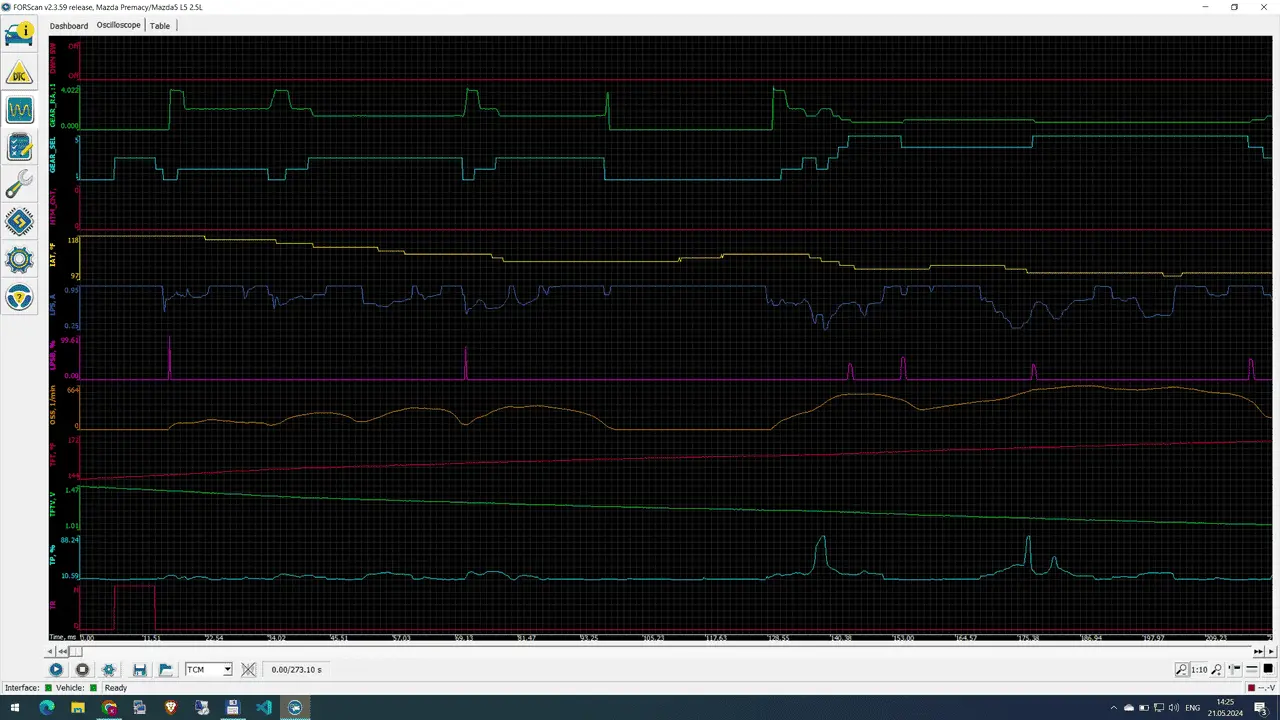

Does FORScan allow monitoring/control of torque convert clutch status? If yes, during the low idle scenario, try setting it lock vs unlock. This will help to confirm it.
From what I observed over a brief drive monitoring session, it does engage/disengage as supposed to - see the OSS graph (orange). The big flat space between 100 and 128 is idling at a stop.
Is there anything wildly abnormal, that should further be investigated in your opinion?
I would greatly appreciate any advice on which parameters to group on this graph that would help to understand what is going on.
Also, I tried feeding this data into chatgpt4o and, to my surprise, it outputs something that now actually makes sense, although, the recommendations are very generic, i.e., "note whether a change in LPSA LPSB correlates with gear shift, look for random spikes on OSS, etc".
