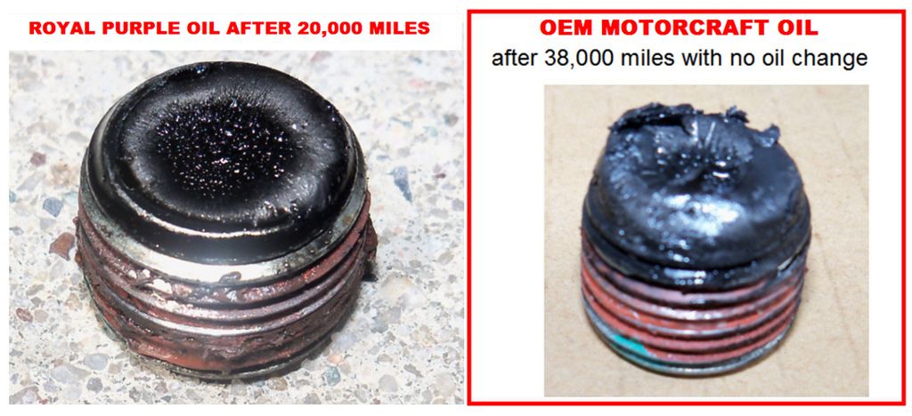

I swapped out my Royal Purple 75W140 transfer case oil after 20,000 miles this morning
(I swapped the transfer case OEM oil at 40,000 miles with Royal Purple 75W140,
now 60,000 total miles on the odometer)
Great news!! absolutely no signs of sludge whatsoever, here is what the plug looks like on the left photo below,
no sludge, some metallic particles is observed on the magnet but that is as expected.
The right photo is for comparison and how the plug looked for the very first time when I removed the fill plug after 38,000 miles on the odometer, notice the thick gunk and how the oil is starting to cake up only after 38,000 miles on a brand new car.

What the heck was Ford and Mazda thinking using such low oil capacity ???!!! It's just madness to think that little oil can last the lifetime of the vehicle, I guess they could care less as long as the car lasts up to 60K then it's our problem.
I'm not going to wait 20K next time, I'm going to make this as part of my regular maintenance when I change my engine oil every 6000 miles, I'm going to change the transfer case oil at the same time.
