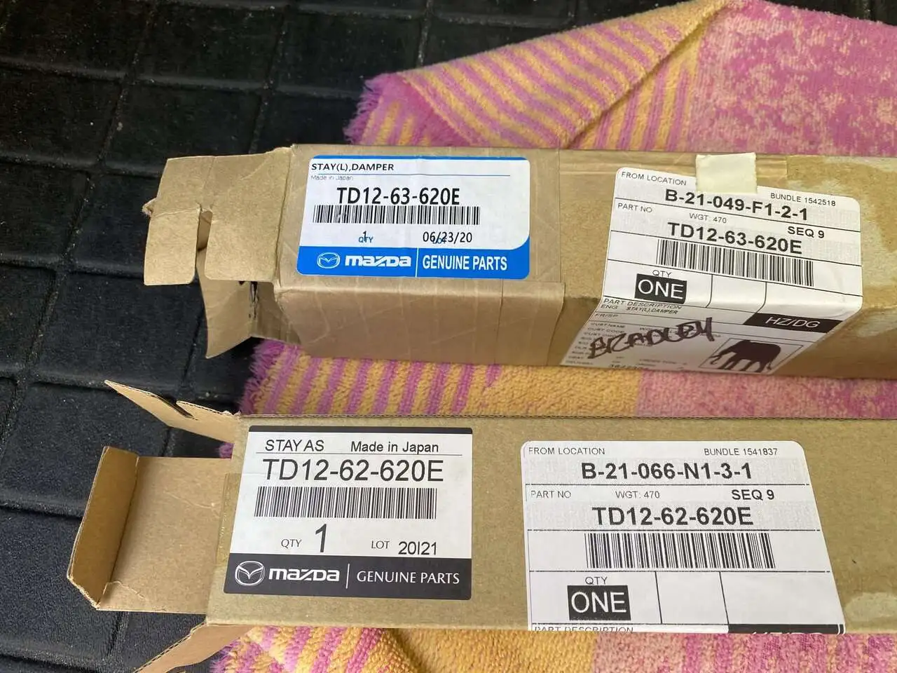

Found an old note....
Tailgate Gas Strut w/ easy close
left: TD12-63-620E
right: TD12-62-620E
Tailgate Gas Strut w/o easy close
left: TD11-63-620E
right: TD11-62-620E
Now I really want to know what the difference is.

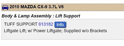

It was pointed out that most of the struts sold say "Without power lift gate"
Do they make different kinds depending on the model?
I've used struts on Ford's and Nissans and always got what it called for. I should add I was able to get power struts(and regular struts) for them fairly cheap compared to having to buy at dealer, as Bronco indicated is the only place to get them for Mazdas. This is my first Mazda.
It looks like the struts may be hardwired and powered.
If they are not then there could be no difference or most likely it could be a length difference. Maybe the struts for power gate are slightly shorter??? Check lengths and check pressure on the spec charts.
Also, make sure to see if powered liftgate struts are powered or just gas-operated.
