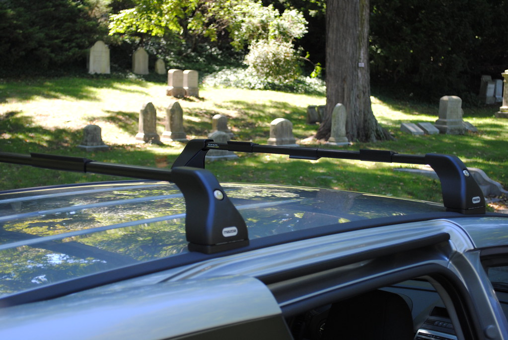

I don't plan on taking any of the bolts out when I take the rack off. I'll just cover the mounts with the provided covers when not in use.
Yes I opened the sunroof completely for the pics. I really just did it so others could see they would be able to use theirs if they kept the rack on all the time.
I'm happy with it so far, especially considering how much cheaper it is than other racks.
I agree. We are riding with the covers now too. Looks OK, but I'm taking them off soon. The wind noise (whistle) was noticeable before the cargo box, then it was diminished but still there. I still haven't tried/figured out why a bungee cord supposedly works?

the OEM rack is supplied with four pieces of 3-sided plastic channelling that snap onto the load bars. the channeling has a slight deflector built in (few millimeter rise on one end). the OEM rack instructions call for placing the four pieces in defined places to stop wind noise. nicer solution than a bulky wind fairing.
i'll try to take a picture of them on my car today and post it here.
okay, these are the "lips" that i was referring to:
somehow, mazda engineers determined that the three shorter pieces on the front bar, with the middle one upside down, and the larger piece centered on the rear bar, provides optimal results.
And they work? Interesting.
I honestly can't think of any instance that I'll drive again with the rack on and nothing on it. We only did it last weekend to check out cargo boxes.
well, i haven't compared with and without the "lips", but i can say that with the rack installed as shown, there is no more wind noise than without the rack. i plan to keep the rack on permanently... i never know when i'm going to find something to throw up there (furniture, antiquing, etc)!

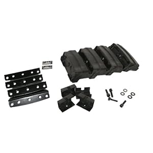

Thanks. According to the Thule website the fit kit is the 3080; I found what appears to be a picture of the 3080 on a British vendor website. This looks quite different from the Mazda OEM roof rack rubber pad (or is it "spoiler"?).
Any other ideas? Hard to imagine carving one of these by hand ... I guess I may be in the market for a new roof rack but if so damned if I'll give Mazda more of my money. So if you want a used Mazda roof rack (sans one bit of rubber) let me know.
The 3080 was created as a replacement of the 3069. Since I imagine that the OEM rack was created back when the 5 was new the 3069 kit is probably going to be closer to what you currently have. I haven't managed to find any pictures of the 3069 kit.

I saw one earlier in the thread - the post was pointing out that the 3069 kit didn't have a good flush fit with the roofline. My guess is that the 4 pads were identical and not customized to the front/back/right/left differences.
