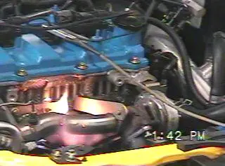

Be careful w/ those wagner manifold's...i would suggest getting an EGT...to watch the temps..
Otherwise this might hapen

Nice pic. . .hopefully a nice manifold. I say that only cause I'm interested in what happened to Dana.

kooldino- did your catch fire from the exhaust leak? assuming ther was no leak=no fire?
I don't believe an exhaust leak caused it. The mani got hot and started to glow. Then because he was a little on the rich side (yup, he wasn't lean), the mani was so hot that it got to the flash point of the fuel and viola, it caught fire. Maybe the thickness could of been the issue, but it also could of been the flow characteristics of the mani that inhibited the exhaust from exiting fast enough and thus causing it to heat up too much. It caught fire between #2 and #3 pistons.
yep. thanks for your feedback. that was a plan of mine. i need to hook up that gauge.
