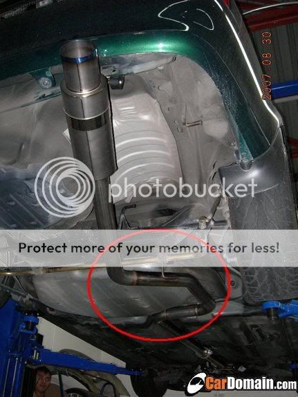

I am more wanting to see pics in the area that I have circled in this picture. Thats like my GHl section that I am going to work off of.

He did. I think he had a few pics also. Im just curious how the apex exhaust routes in the area of the gas tank. Cuz all thoose bends on that last picture Strike me as kinda wierd.

Yeah I figured that would have to be done. No biggie. I guess the only thing I am unsure about is how the apex exhaust and other custom setups have routed the piping in the area around the gas tank.

I see where you are coming from on that. It is very easy for an under the axle setup to look like s***. But I have seen some that look really good. I think it is all in the angles and design. Thats why I am trying to get as many pics as I can before I attemp it. Too many bends would make it look like s*** right away. Im trying to get the routing of the piping to flow as smoothly as possible.
