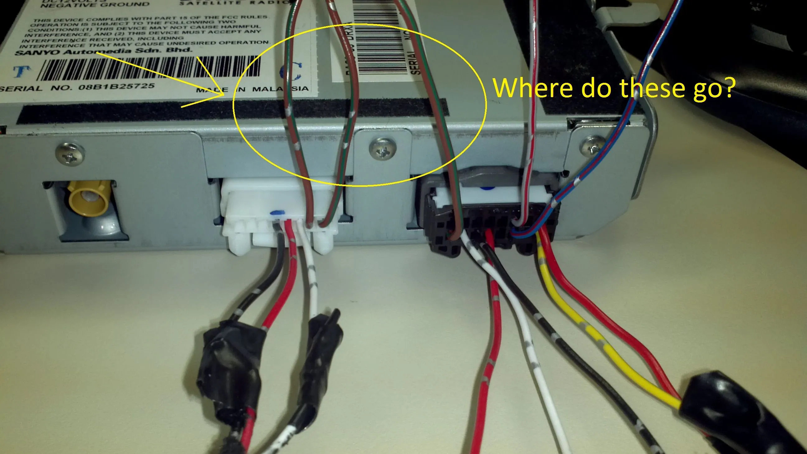

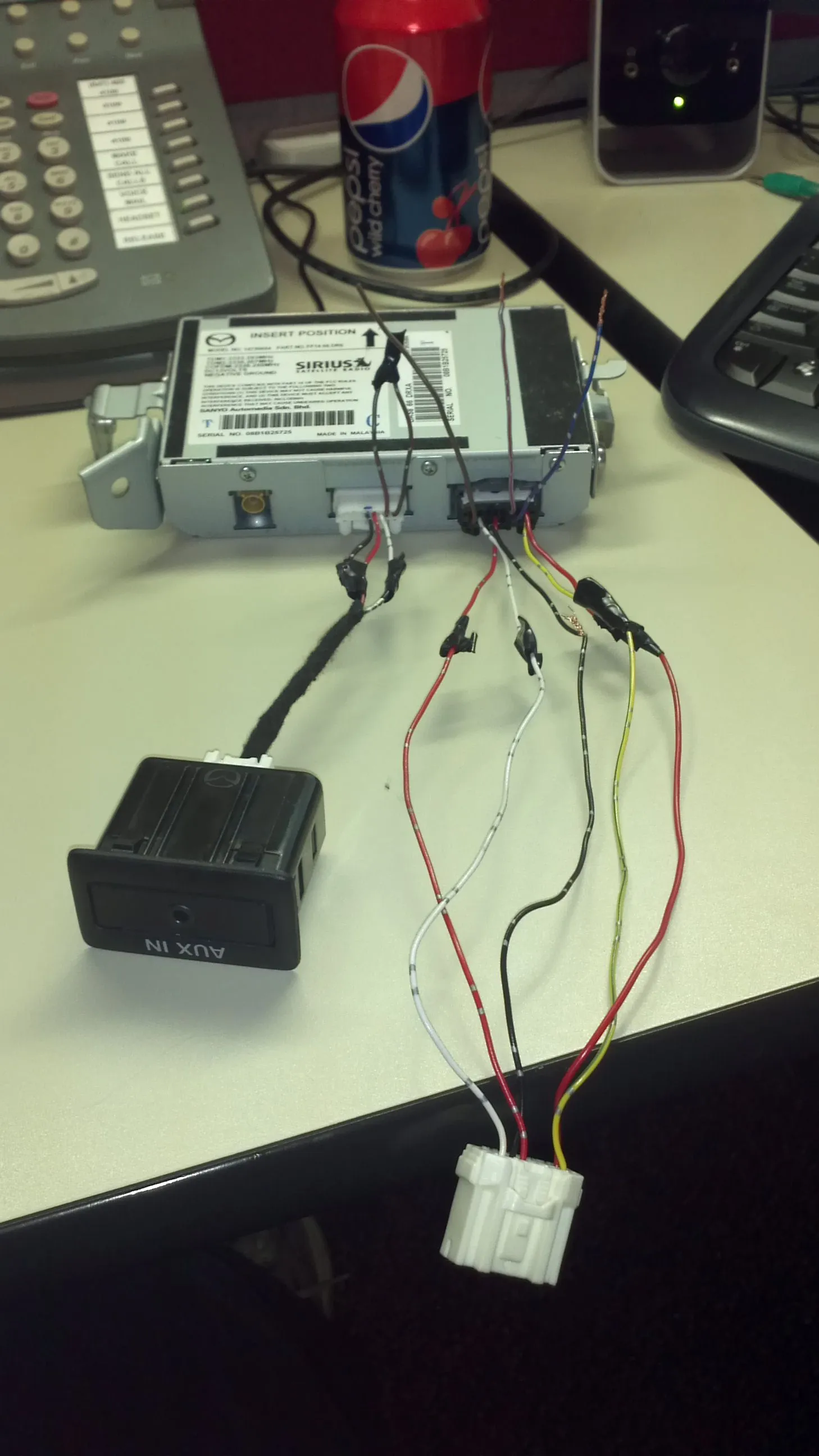

Does anyone have, or know where I can find, a pinout for the '08.5 MS3 Sirius/ACI box? I recently sold my headunit to a friend who has an '04 MZ3 and was looking to utilize the ACI (sirius is not really required, but more of a 'if it works, why not?' kinda thing). I've pulled the switchbox out and wired as much of the harness back together as I could manage, but I have 3 brown wires with green stripes left that I'm not sure where to connect. My current status with everything wired up is this:
-Sirius box is connected to aux port on back of headunit.
-I have the two power(signal?) lines (unsure which is which, I matched the colors- grey w/red stripe and blue w/red stripe, highlighted in the picture) connected to the OEM harness, which powers the Sirius box and the Sirius button on the head unit works
-I have the ACI jack wired in, except the two brown w/green stripe wires
-The Media button on the head unit does nothing.
See picture for how I have it wired up, any info would be appreciated. I've searched through every Sirius/Aux input thread on this forum to no avail. I can't find someone who has installed an '08.5 head unit into an <'08 car. The switchbox required for the earlier models won't do me any good.

I'm transplanting the whole system into the '04. My headunit + related accessories. The '08.5 headunit itself hooks up to the '04 harness and works just fine, with LCD output. The problem is getting the Media button to function properly. I did some more digging and discovered that the brown w/ green wires EDIT: MAY need to be shorted out to create the logic that the AIC is plugged in. Seeing as the headunit is in Ohio, and I'm in IL I was hoping for a little more definite answer before driving all the way out there to complete the install :)
