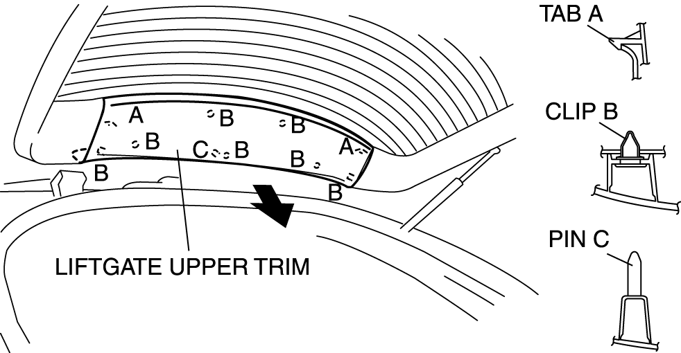

Straight out of the workshop manual for 2013:
REAR SPOILER REMOVAL/INSTALLATION
1. Disconnect the negative battery cable.
2. Remove the liftgate upper trim. (See LIFTGATE UPPER TRIM REMOVAL/INSTALLATION.)
3. Disconnect the high-mount brake light connector.
4. Remove the nuts.
5. Detach the clips and remove the rear spoiler.
6. Install in the reverse order of removal.
1. Detach tabs A, clips B, and pin C by pulling them in the direction of the arrow.
3. Install in the reverse order of removal.
