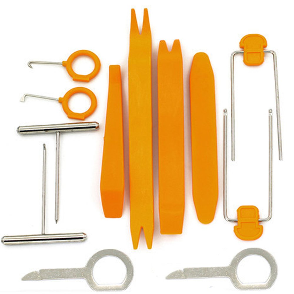

Yeah it does make many first-timers frustrating trying to replace that luggage compartment light. Read the hint by Panther and more detailed instruction from Anchorman's PDF file, and get a set of this cheap trim prying tool, you'll be fine!

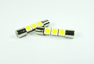

Well that's why you need to be careful choosing LEDs for vanity lights or the wife may not be happy about it. I use this 2800K "warm-white" Festoon 6641 3SMD LED for vanity mirror on the sun visors for "warm glow" effect with pretty good result:
