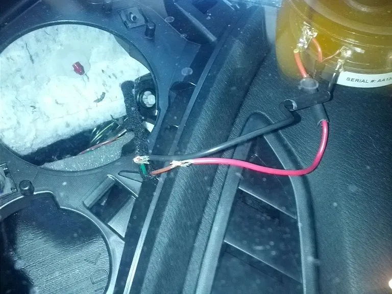

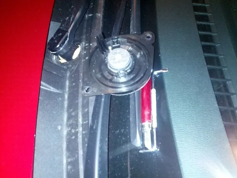

After lurking over in the CX-5 area, I decided to check how similar the 6 was. Popped off the dash tweeter grills and found similar to what CX5 guys were finding. Had a pair of refurb e-bay Polk 3.5" coax in my parts bin so removed the tweeters w/ angled #2 phillips. Cut the connector off and then stripped and soldered - heat shrinked the joint - and then found a plastic boss that supports the cable interfered. Using a sharp woodcarving tool - shaved it enough to fit.

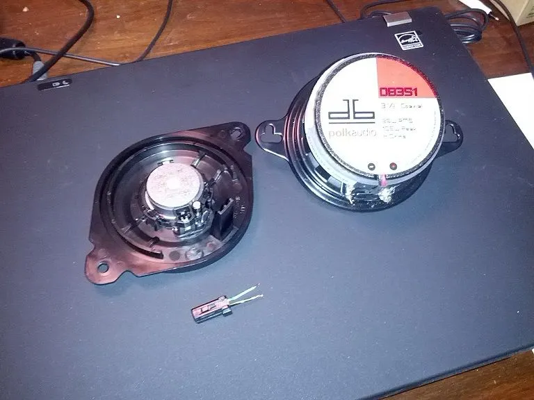

Tweeters removed are 4 ohm 25 watt and measured 3.5 ohms. Coax also were 4 ohms so audio head should not see any difference.
Very tight working space - pics show speaker comparison, magnet is 2.75" so a 2" magnet would avoid the difficult trimming.
Solder pic shows the trimmed boss @ the end of the fuzzy orig cable.
A rachet angled #2 phillips like Harbor Freight carries would speed things up - most work is outside looking thu the windshield and reaching around.

I thought the green wire was negative, but you have it hooked to the positive of the Polk speaker. Can you confirm the color of the wires and the polarity. Thx
Yep Green is negative - I may have to pull that speaker back out to check if I did it wrong - tho speaker mtg screws only go into plastic so it works fine.
Opps - Wait - look closer at the pic - green is hooked to black - brown to red, had me going there for a minute (hi)

I must have been looking with a squint (freak), you have made the right connections. Based on your write-up I ordered the DB351 speakers from Amazon yesterday, hopefully I will have similar experience as you.

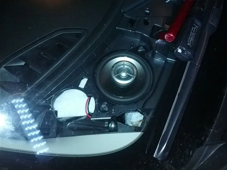

Any pics of the final product before putting the grills back over top of them?
Do you think it'd be possible to get a 4" speaker in there?
I did quite a bit of trimming to get the 3.5" in there - I'd say 4" would be very difficult. pc att.
Also I went back and trimmed the honeycomb bracing underside of the grill mesh just above the tweeter section so grill does not touch now when clipped back on.
