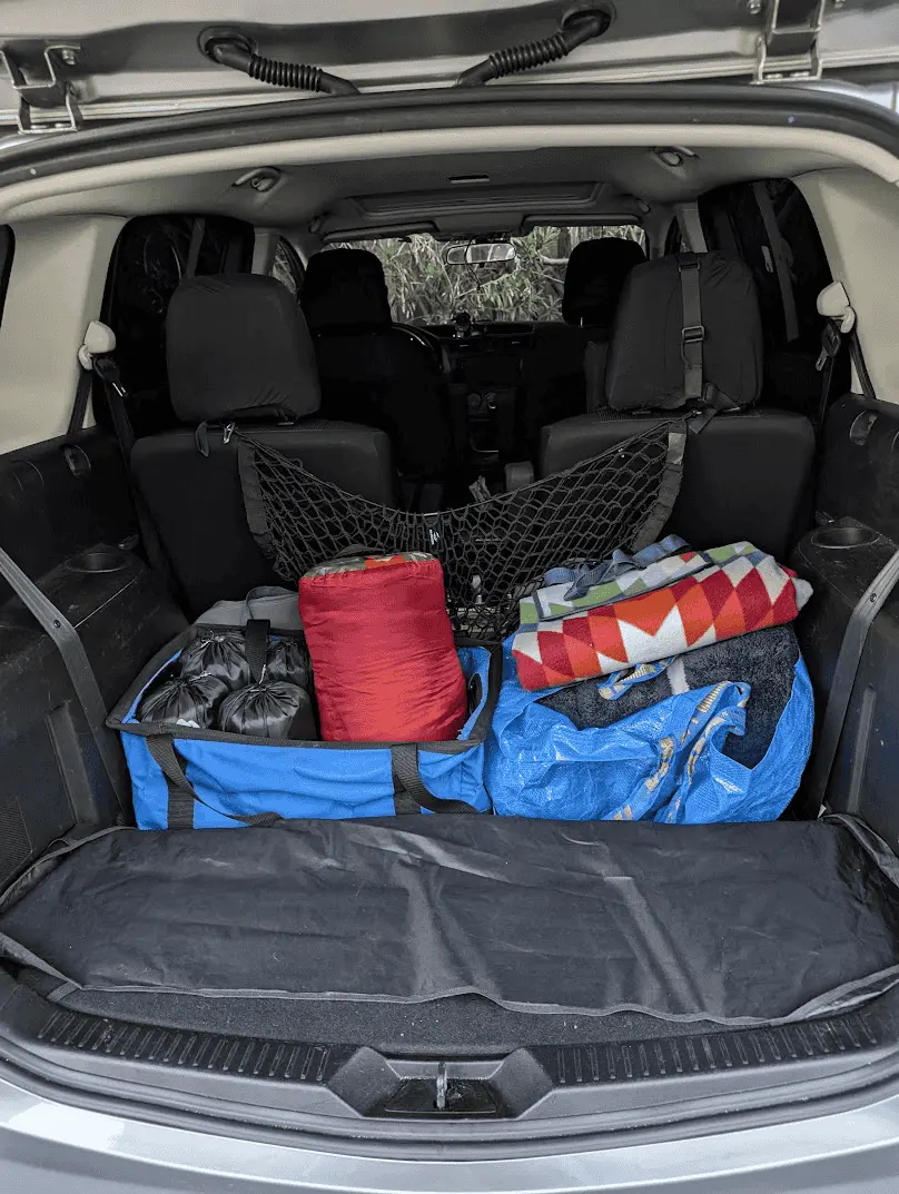

Deleted the third row before this summer's trip and I got to say it was a great decision!
Now, inspired by the "bam beds" inserts, I'm thinking about building a lightweight platform to level the floor.
Although, this would be unnecessary and would add extra weight.
One more thing that I wanted to mention: I decided to keep the plastic part that holds all the tools, with the original cover. Just removed three clips to disconnect it from the fabric of the rear seats.
Highly recommended modification!
