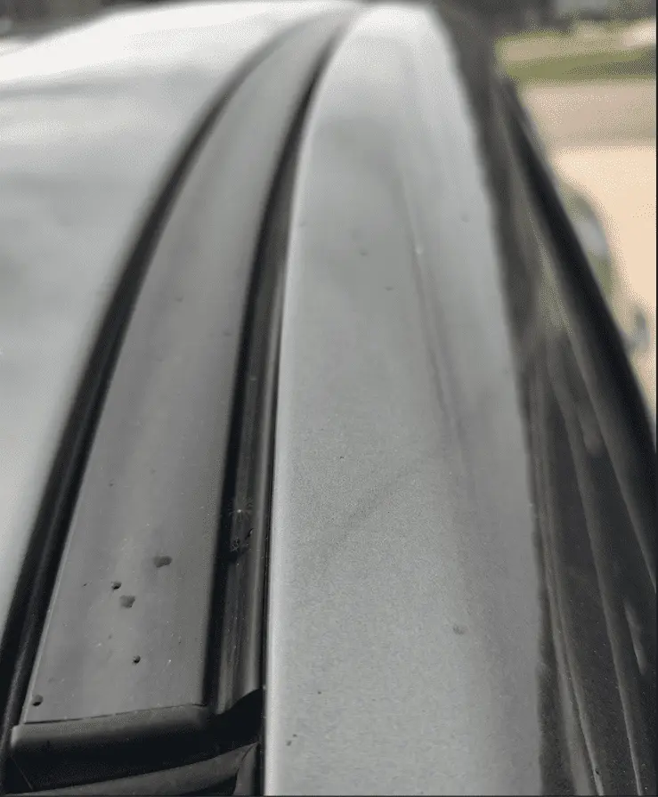

Here is what the roof looks like with just the moulding. see the gap on the inner side ?
also, you should keep the rails in case you decide to paint black and install later.
Awesome, thanks for the pic! It does in fact look like the same moulding/gap on inner side which I was concerned about. I will take another stab at installing them. Appreciate the help. I currently have them for sale on here but you're right, I might as well just keep them if I ever need them.

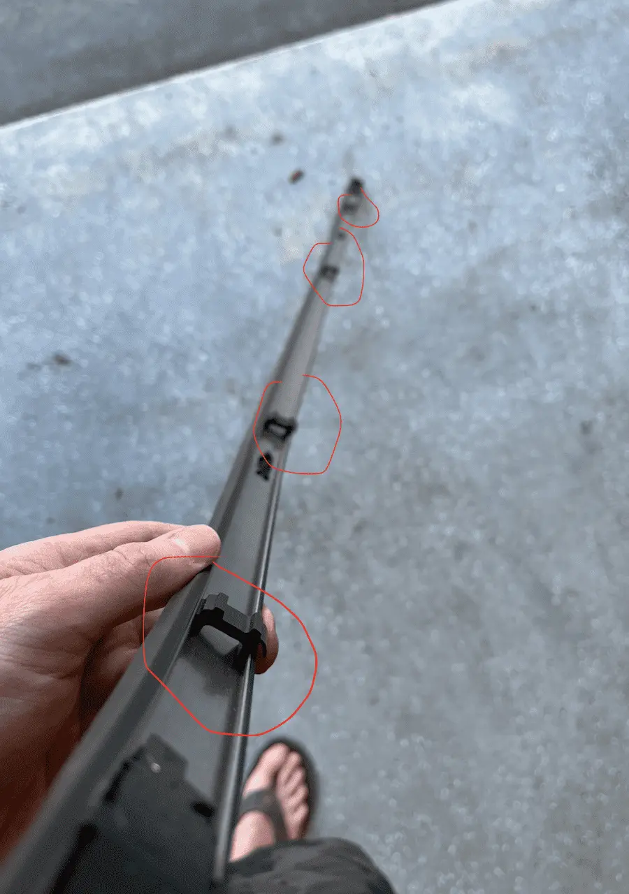

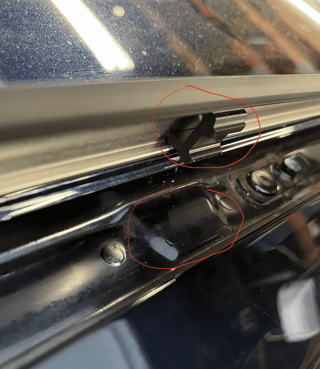

I went for install attempt #2 today. Did not go that well actually. There are two clips on each end of the roof moulding which fasten it to the roof. Other than the there are about 4 rubber 'clips' or pieces which do absolutely nothing. There seems to be a bump on the roof where maybe there should be a piece they slide into or something but there is nothing there. So with nothing but the two end clips holding it down the moulding piece wiggles a lot and does not seem secure.

I went for install attempt #2 today. Did not go that well actually. There are two clips on each end of the roof moulding which fasten it to the roof. Other than the there are about 4 rubber 'clips' or pieces which do absolutely nothing. There seems to be a bump on the roof where maybe there should be a piece they slide into or something but there is nothing there. So with nothing but the two end clips holding it down the moulding piece wiggles a lot and does not seem secure. View attachment 313149
The clips are slideable. Slide past the raised portion. There are videos that show removing the moulding and putting the roof rails on. Some are in very good detail and you should be able to see how the moulding was clipped on by seeing them remove it.
EDIT
If you look immediately to the right of the raised section you circled, you can see where the clip should snap down onto the square (with round bump).
Upvote 0
