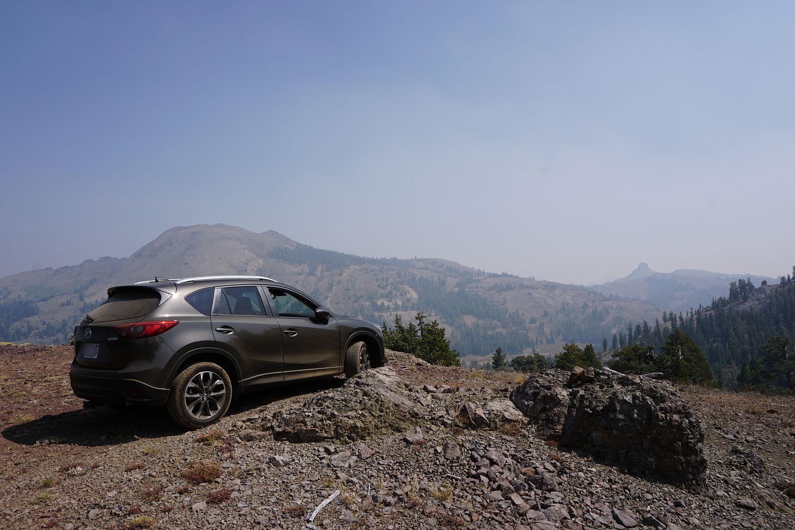

Off-road driving skill is 100 times more important than skid plates. This is not the type of vehicle that anyone is going to be winching up rocky gulches like a boat out of water. I drive mine all the time on rocky backcountry roads in the North Cascades and there are plenty of rocky washouts that go un-repaired all season. Either the rig/driver is capable of traversing a washout or it isn't - a skid plate is not going to change that equation. Just go slow and easy and, if it looks like you might bottom out, a little manual rock work might be called for. A skid plate is not going to change that fact either. And I've not encountered any washouts I couldn't cross except for one where the road just ended (slid down a ravine). I've been around one washout that a Dodge Power Wagon 4x4 coming down the hill stopped and told me the road was impassable about a mile uphill. The CX-5 was able to drive right around it with inches to spare.
The one thing you are right about is the front air dam. It does scrape easier (in general) than the metal underbody. But it's not a huge deal and, so far is flexible enough that it hasn't cracked or been torn off.

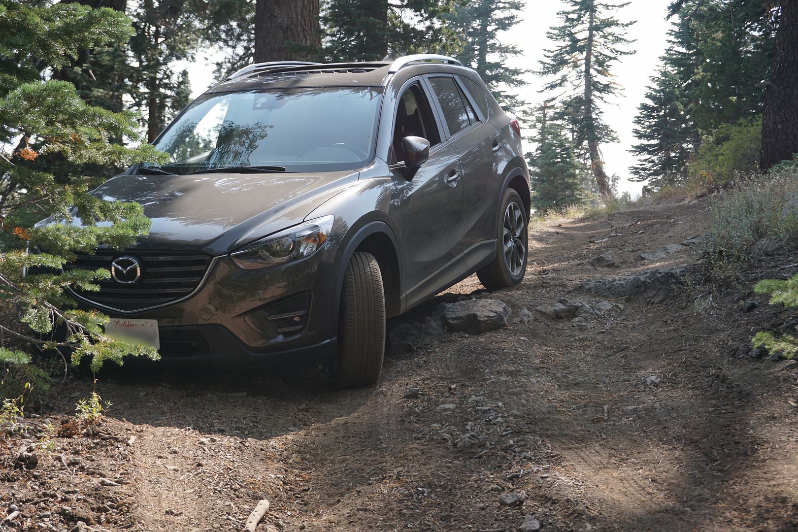

IMHO...having done some not so easy trails in my CX-5, the approach angle is actually pretty good for a non-lifted truck. There is a plastic enclosure that runs the length of the bottom of the vehicle, which protects most parts from small hit's (ask me how I know). That being said, if I was going to do this regularly, I'd invest in a small lift (3" +/-) and an aluminum skid plate to better protect the underside. Oh...and some rocker protection (although the plastic trim panels do a decent job of it).
Edit - and some brush guards...creeping along a tight trail to avoid scraping the body can get old...
