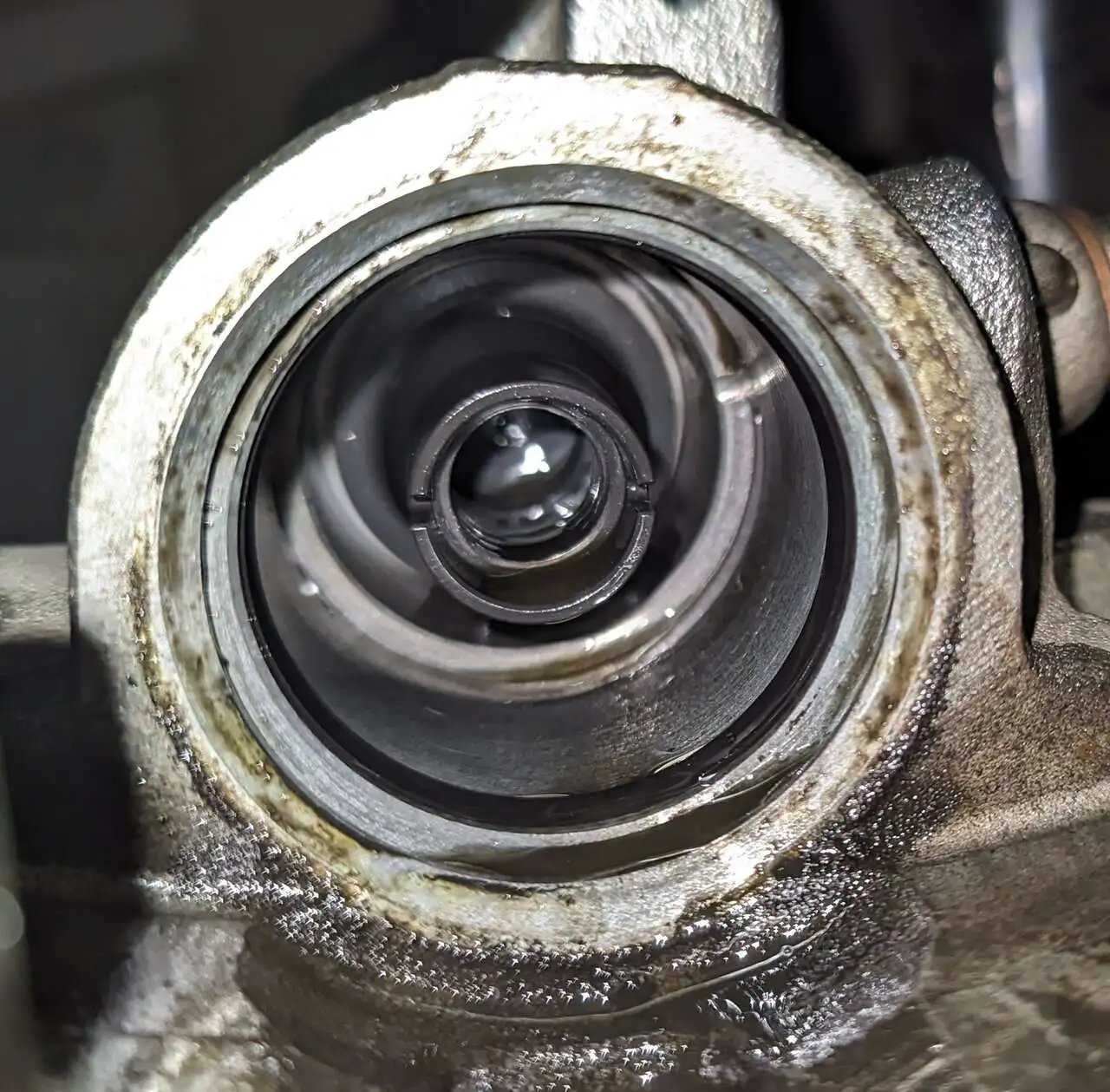

Long story short, I'm in a bit if a pickle. I ended up remembering to put the parking brake into service mode AFTER removing the caliper, and the process requires you to step on the brake pedal, so it pushed piston to it's travel limit and bound it up. In a fit of despiration, a backed the small nut off the backside of the caliper until everything came apart. Reassembly seems straightforward enough, other than a small circlip that I can't figure out the proper location or installation of. Any advice, guidance, or diagrams? Should I just bite the bullet and order a new caliper?

I only did one side because I was changing rear pads, and never made it to the other side of the car after hitting this roadblock. I took it apart because the I pushed the brake pedal (to put it into service mode) while the caliper was off the bracket, and the piston went to full extension. I couldn't get leverage or my retraction tool in the space remaining to force it back in. I tried removing the EPB unit and turning the small nut on the backside of the caliper in hopes of retracting it. Did not realize I needed to turn it CLOCKWISE to retract, and the whole piston eventually came out of the caliper body.

I took the daredevil route from this same bad spot and reassembled the caliper. The Circlip goes on the threads - that much I'm sure of. The exact location and direction of the clip are just educated guesses, but I put it on with the little protrusion last, effectively pushing the clip onto the threads. I threaded it only 3-4 times around, as the female threaded pipe in the caliper housing has little notches to catch that protrusion and those govern where the circlip ends up when the rod is threaded into the pipe.
Once the internal portion of the EPB was threaded in (all the way but don't tighten) I slid the boot to the other end of the piston so it stuck off a bit and I could seat it without risking damaging it. Make sure to POUR BRAKE FLUID INTO THE CALIPER before putting the piston back in, or you'll be bleeding the line for a week. Seat the boot, push the piston down and wiggle the EPB shaft to make the piston line up, then slide the boot back into the original trench in the piston and push the piston down all the way. Reassemble the caliper the normal way, bleed and test. So far both the pedal and the EPB are working perfectly for me.
