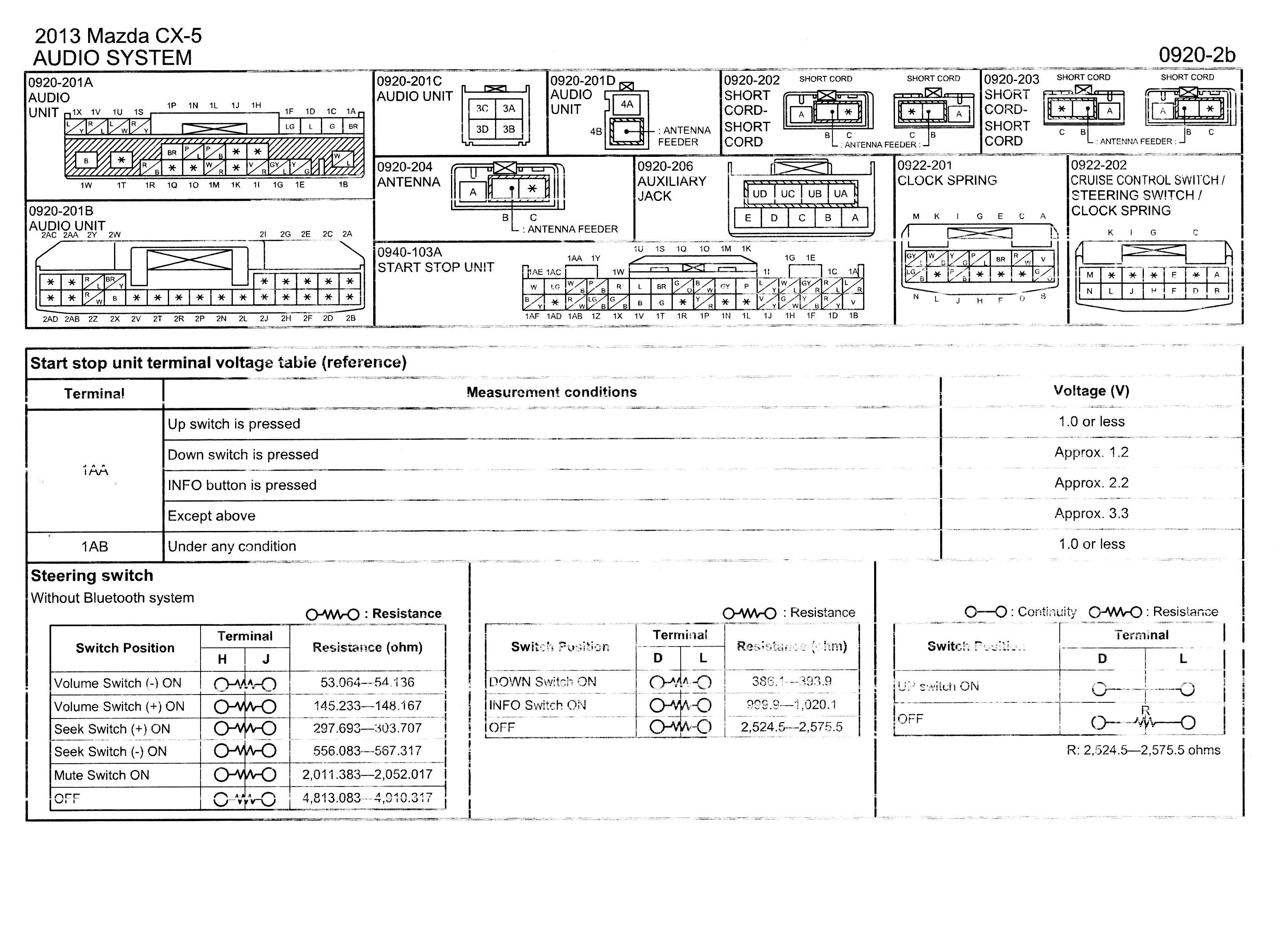

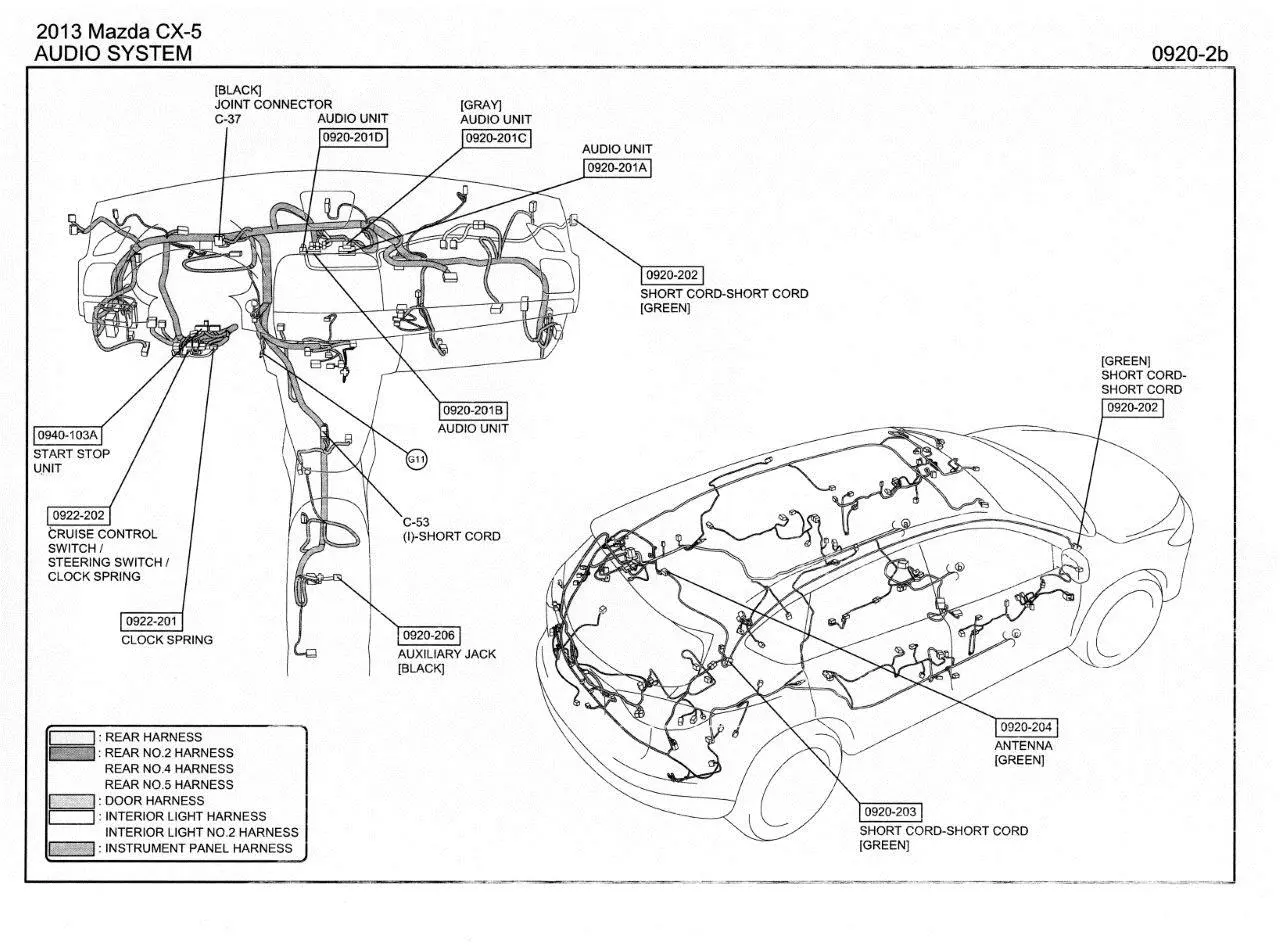

Does or has anyone installed a backup camera on a CX-5 Sport with the HD stereo? Are all the CX-5's with HD stereos prewired for backup cameras? I have a stereo wire diagrahm, but do not see a video input on it. I cannot imagine the HD stereo in the sport is any different than the HD stereo in a GT with a backup camera. Any ideas or speculations out there? I have attached a few PDF's that may be helpful in figuring this out (I don't undstand all of it).

I read that the CX-5 has in effect, a local area network with several computer control units, all connected via a twisted pair. The rear view camera and the rear lighting is all connected to a rear control module and the data is transfered to the video display via the computer control twisted pair. This design greately reduces wiring and weight so there is no video-in line to the video unit and the rear control unit turns lights on as dictated by the central cpu without wiring back to the light switches and turn signals and brake switches etc. It also consolidates the data from the Blind Spot monitoring and rear parking sensors and puts it on the network so the front control unit can turn on the lights in the rear view mirrors and buzzer as needed.
Thanks GAXIBM....that's a lot to take in. lol. So the next question is; would it be possible to figure out which wires in run from the hatch to the stereo that would carry that camera signal? I am to assume to that it is activated by the reverse lights being going on when backing up?
I think the twisted pair is on all models and links all control units. The camera is wired to the rear control module. My guess is some software/firmware and maybe an upgraded rear control module is also requried to get the rear control module to forward the picture to the display unit when you put it in reverse and the display unit will have to know its equiped and display the picture when you put it in reverse. You might take a look at your rear control unit and see if it has a input for the camera... Probably easier to go with aftermarket add ons.
