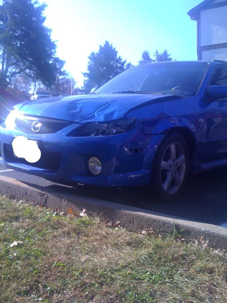

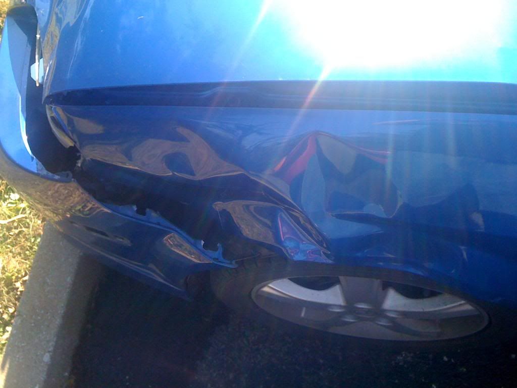

The night before Halloween, I hit a deer. Driver front corner. Like so:
(Okay, maybe the car WON the fight - she was in the hospital for a few weeks, but the deer didn't survive.)
After the collision, my tail lights, turn signals, reverse lights, and hazards no longer functioned. Brake lights still worked.
