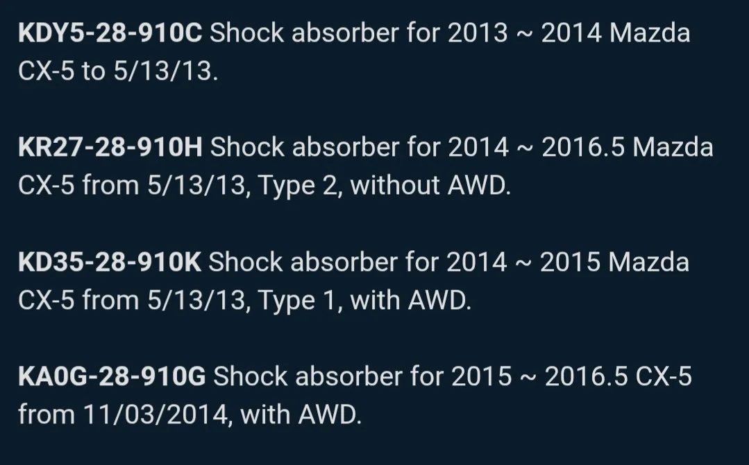

I fell down the rabbit hole of all the different rear shock absorber OEM part #'s there are to choose from and am second guessing everything.
I have a 2015 AWD Touring built in 2/14. It uses the newer stud and nut design on the lower shock mount. The following chart has been passed around on this form and going by that, you would think that PN# KD35-28-910K would be the one I would need since I have AWD but I have contacted multiple dealers and they all say PN# KR27-28-910H is what comes up under my VIN# in their system.
I really want to go with the 910K part as it is slightly cheaper. On the dealership OEM parts websites it lists both part#'s as being compatible with my car but It's just odd to me that they would recommend the one that clearly has "without AWD" in it's description. Meanwhile, the 910H description states "with AWD". They insist 910H is correct regardless
I suspect both shocks would mount up fine and it's more than likely just a matter of slight differences such as the dampening tuning being different. If this wasn't the case, then how can KYB offer a shock and mount assembly that covers all models 5/13/13 and newer, for gen 1 CX-5's? (KYB SA-1008). Do we know what the type 1 and type 2 designations of the 910K and 910H actually mean? Could type 1 be the lower shock mount that uses the older standard hex bolt and type 2 using the nut and stud that is threaded into the knuckle?
