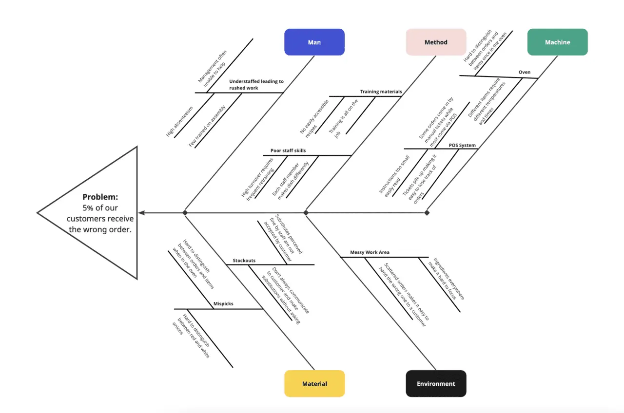

So, since it never happened to you I guess it couldn't happen to anyone else? Do you see the flaw in that line of thinking? Now, before you answer, I live in Florida too...and it happened to me. There are many things that can cause a window shatter in extreme heat. In my above post you will find an example of an Ishikawa Diagram (Fishbone Analysis), fill that out and find out.
