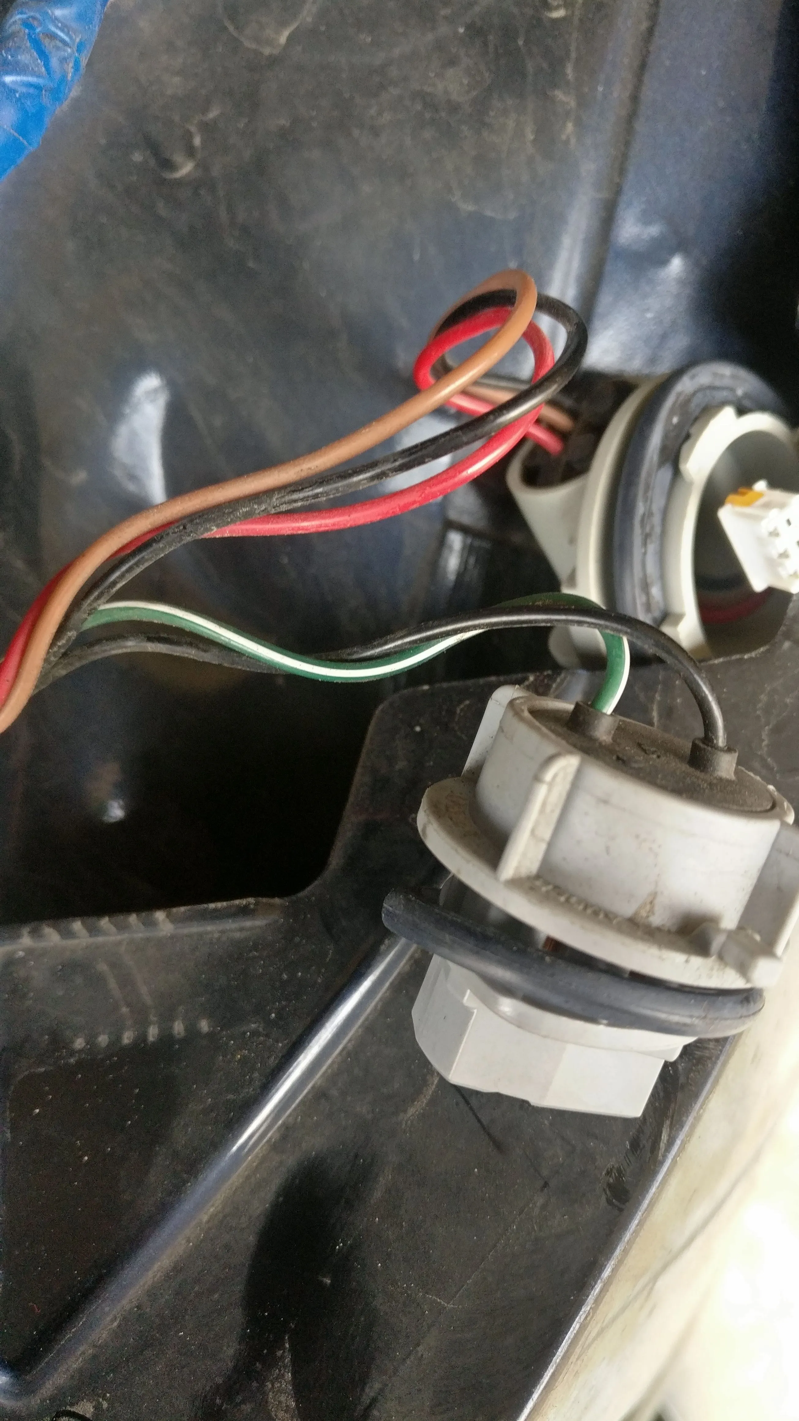

I tried to install mine and it didn't work like I hope. I don't have the same wiring from car..
So far, I wired:
Red to red
black to black
Yellow to green/white
Green to brown
I got turn working. However, it seems like when it brakes, it turns on the low light when you turn on the lights, and when I turn on the headlights, it glows like I am braking.
When I have the head light on and brake, I don't see it glow brighter. Any help?
So far, I wired:
Red to red
black to black
Green to brown
SWITCH
Yellow to Brown
Green to Green/White
In post #17 I put the color of arrow going to which color of wire. (y)
