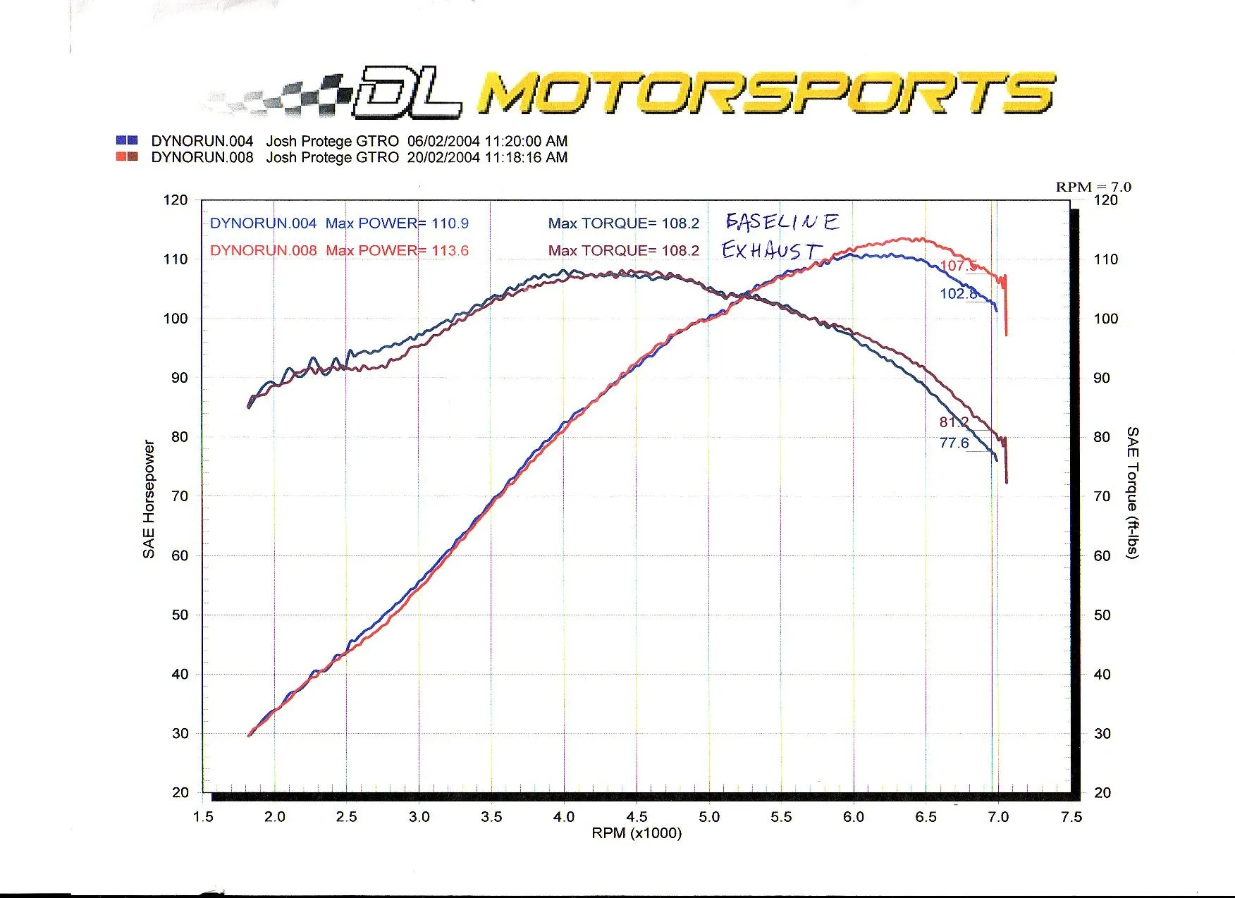

I have 2.5" exhaust on my car, but mine's only a 1.8. So I did lose some torque. What's the Mazdaspeed exhaust? 2.25"? And it's bolted to a 2.0L. Look at my dyno after exhaust. I lost maybe 3lb-ft from 2500-3200RPM. I LAUNCH at 4500RPM. But look at the gains above 6000RPM. Trust me, your car is faster the way it is. Unless you don't like the way your car sounds, leave of the resonator.
