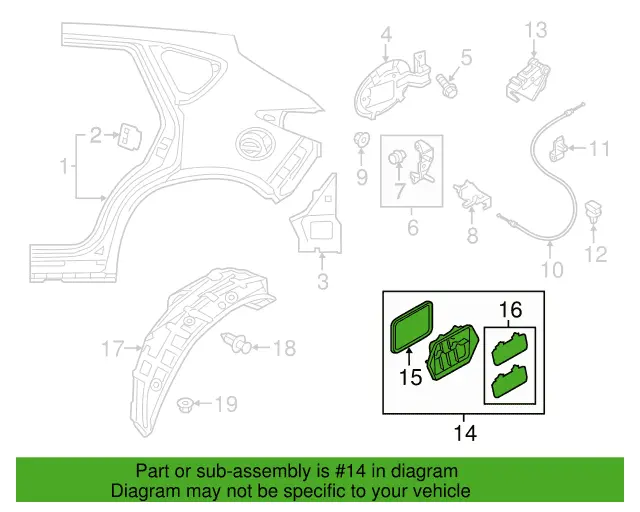

I did some further googling and found the attached (its for the previous gen, im assuming there both the same).
What is the purpose of these vents? If I removed the vanes, to stop them rattling, would there be any issues?
Does anyones elses rattle?!
When you have the windows up, all doors but one closed, you rapidly close the remaining door, the air pressure has to go someplace. The vents allow that air pressure to escape. The vents then shut and reduce the likelihood that water / insects / rodents get into the vehicle. If you remove the vents be aware that there is now a direct path into the interior of the cabin for whatever. If you go this route.. maybe a small amount of sound deadening material around the area instead of removal of the vanes.
