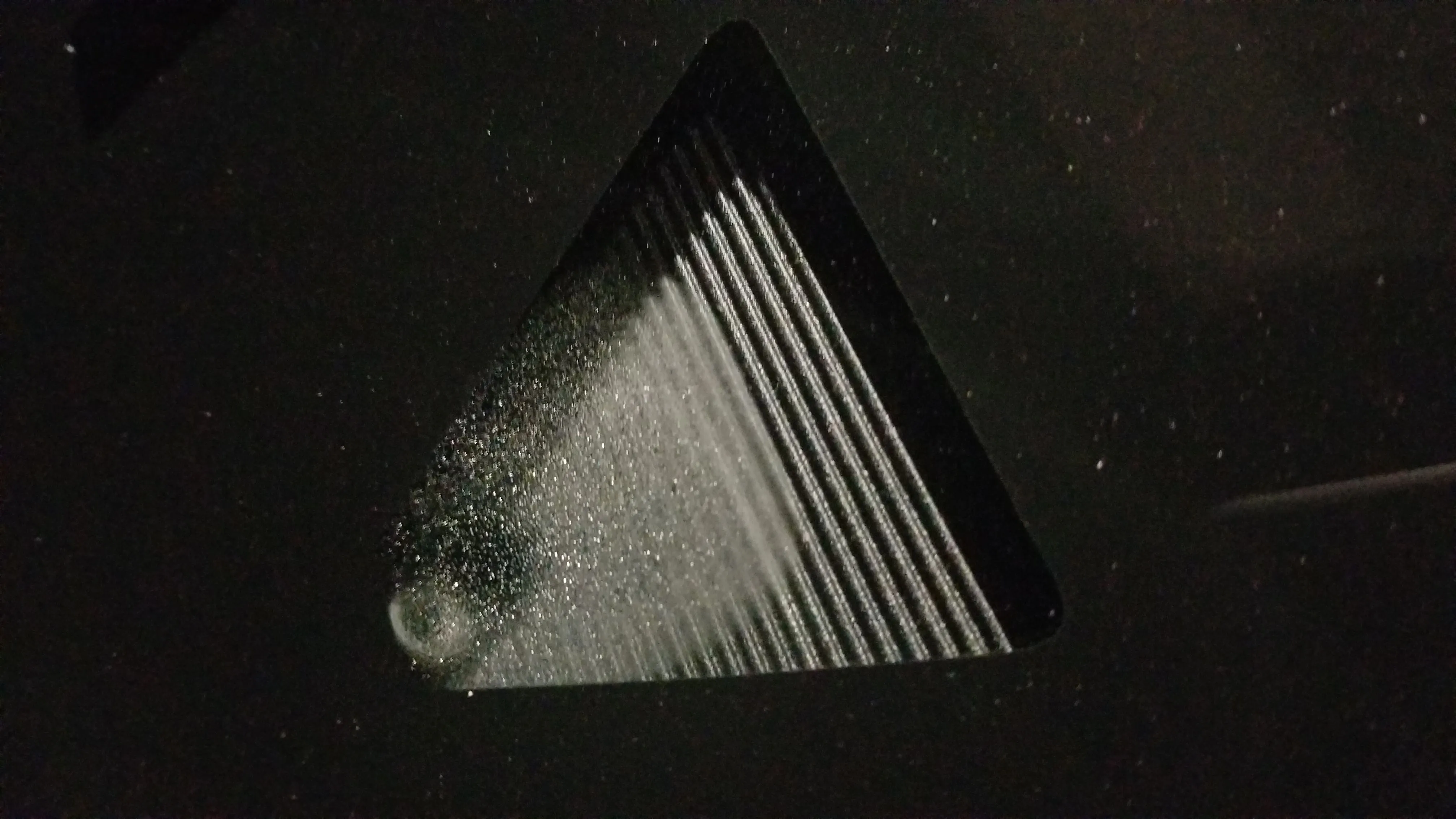

Condensation. I had the exact same thing. There was a temperature drop during the day. Is there a way to switch to traditional cruise control when the front radar emblem Ice's up while driving in the highway like on a Honda?
Any time my system has not worked due to condensation blocking the camera (actually happened twice because of condensation and again this morning for a very long time due to frost), you get the "System Disabled" message in the middle of the speedometer until the condition clears.
