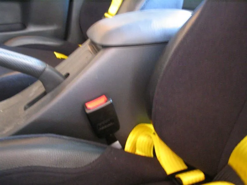

EDIT: if you do go for the Torino, Sparco makes adapters, universal sliders and brackets that fits the protege/mp3. You won't be able to fit anything under the seats though. Also, the seatbelt thing will be a very tight fit between the seat and the center "armrest" area. The brackets are height adjustable which is cool. It's got 3 positions, but it's meant for a "set it and forget it" type of deal.

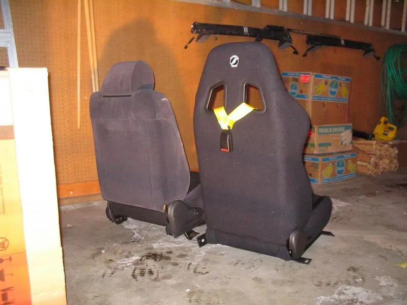

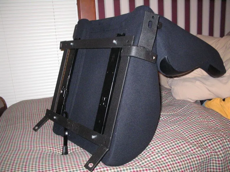

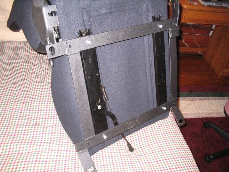

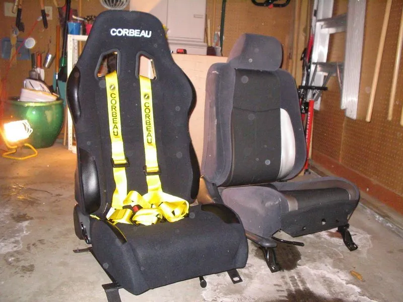

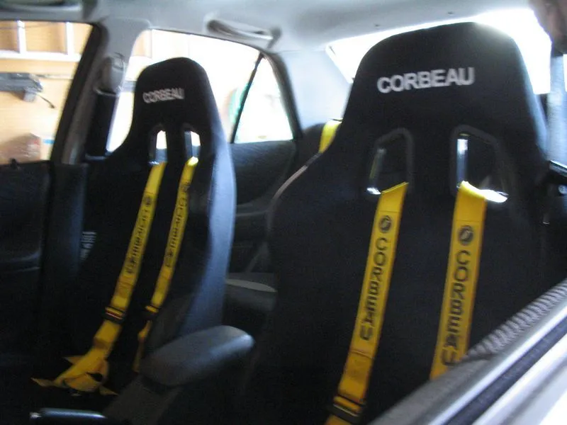

For those of you who are curious, here are some pictures (courtesy of PDHAudio83) of the Corbeau A4's next to the stock seats (brackets and all):
Few more:

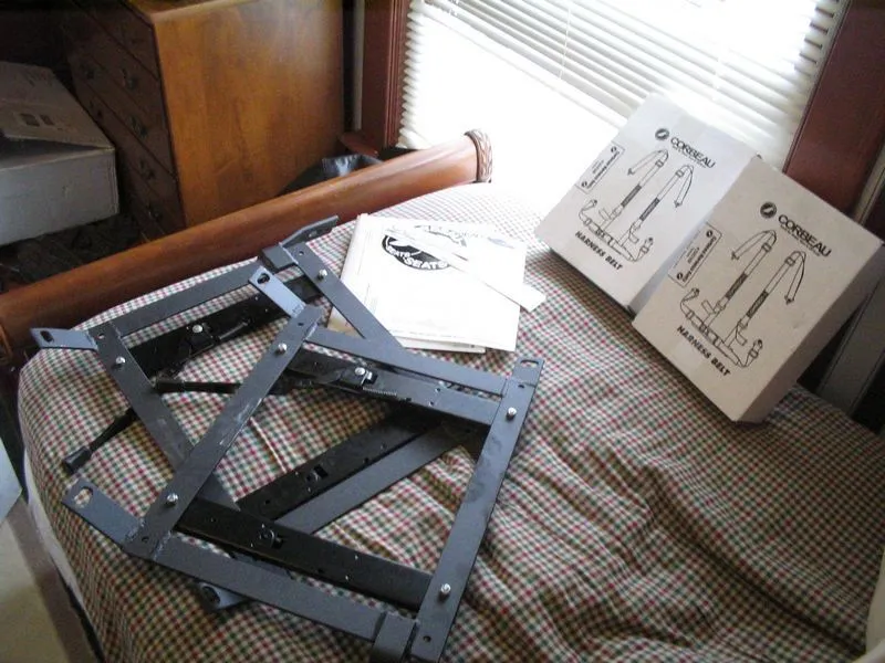

Brackets:
The seat brackets needed for the Corbeaus are the:
Driver's side = E2044T $99
Passenger side = E2045T $99
Bracket Guide here: Click Me
The brackets needed for the Sparco Seats are as follows:
EDIT: '99+ Protg, part numbers: 5002044 (driver side) and 5002045 (pass. side).
