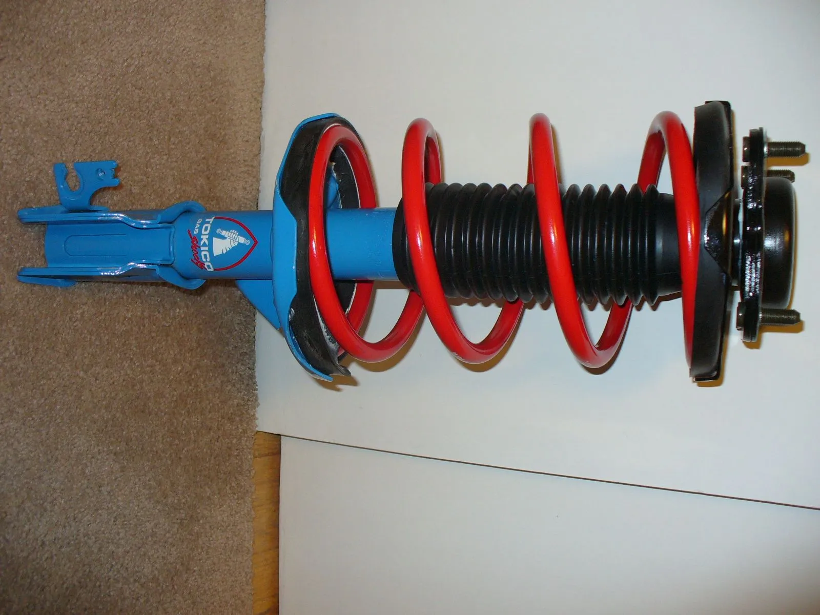

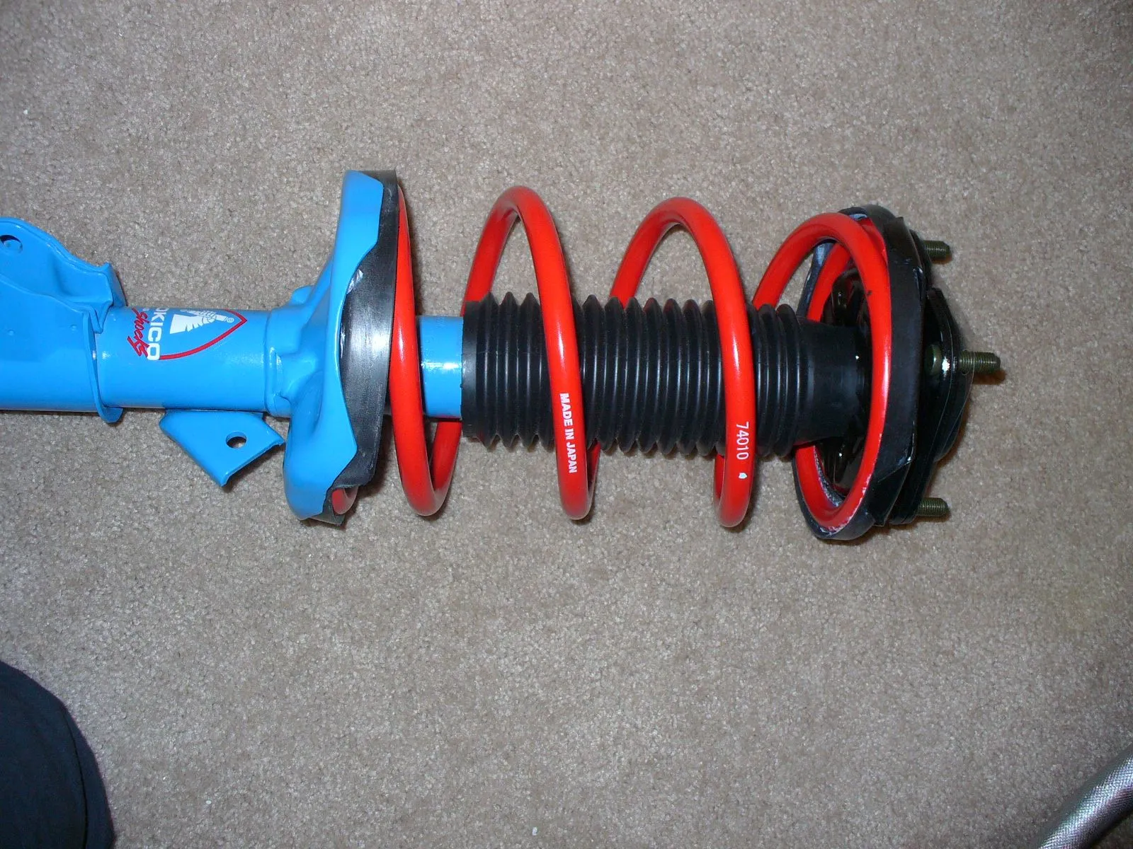

Here are some pictures that might help. I purchased new spring seats (rubber), new strut mounts (MazdaSpeed for front) and the MSP bump stop (shorter for the lowered suspension). I was able to get the new springs on the struts without a spring compressor (with a little arm strength(boom01)). Hope this helps!

Thanks. I realized not too long after I posted that the rear springs were different than the front. Once I had this epiphany it became pretty obvious that I would reuse all of those pieces. I do appreciate your help though.
