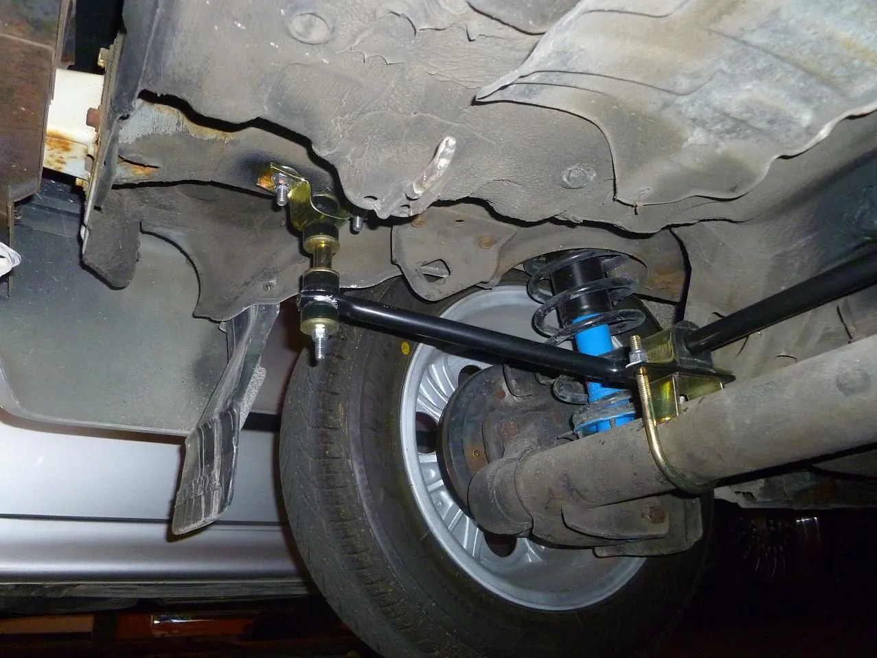

I just put a Addco sway bar on the rear of my '86 CRX Si. It doesn't have any 'stopper' to keep it located, but I just checked underneath after about 400 miles of driving and doesn't seem to have moved at all.
This significantly improves the cornering speed and confidence in the CRX, without much if any noticeable trade-off in ride quality.
