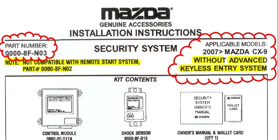

I have the Security Upgrade Kit in front of me. The kit (Mazda Part # 0000 8F N03) supposed to be add on only. The control module's name is confusing (Part # 0000 8F D11A) as it is called "Security Main Control Module".
Even more confusing is the installation instruction, saying: Applicable models: 2007> Mazda CX-9 WITHOUT Advanced Keyless Entry System! I thought the advance keyless entry system was standard on the GT models....
Also note, that this kit is NOT COMPATIBLE with Remote Start System (Part # 0000-8F-N02).

Good to know regarding the remote start system and shock sensor not being compatible. I wonder if my dealer will arrive at that conclusion tomorrow morning when they price both for me to be installed. Given a choice of just one, the remote start is the one for me. The dealer wanted to install a Viper 2-way alarm for me as well and I shot him down. I guess we may revisit this.

Incompatibility confirmed!!!
Just got the confirmation from my dealer, and Mazda Canada:
The shock sensor upgrade kit will not work if the vehicle has the "smart" keyless system.:mad:

Yeah, same for me. Double :mad::mad:.

If you read the Features and Specs page on the Mazdausa.com site, it will say that Anti-theft perimeter alarm is standard on GT, where as Anti-theft perimeter alarm including shock sensor is dealer installed accessory which is NOT available for GT.
