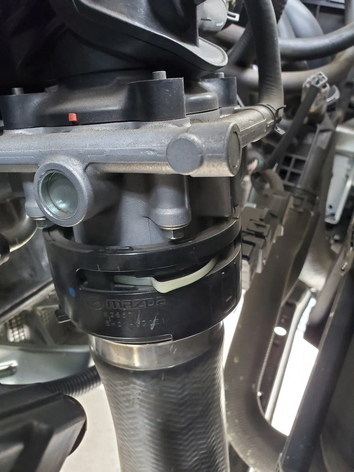

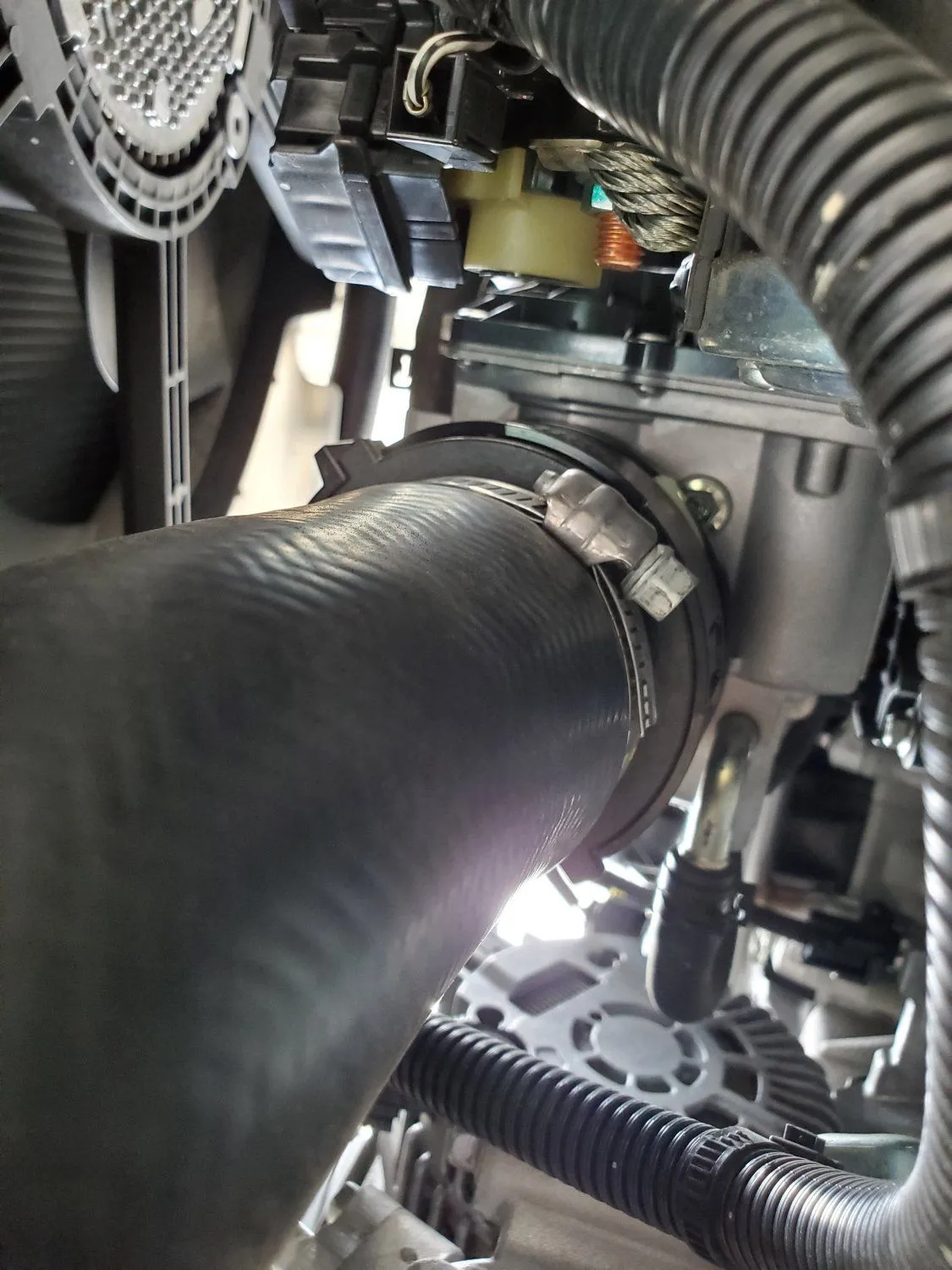

I've only gone as far as removing the actual charge pipe off of the connector. As you can see the connector is locked to the throttle body. My goal is to remove it so I can gain access to TB for some cleaning. I've tried depressing the clip looking white plastic while twisting/pulling the connector but no dice. Can anyone shed some light?

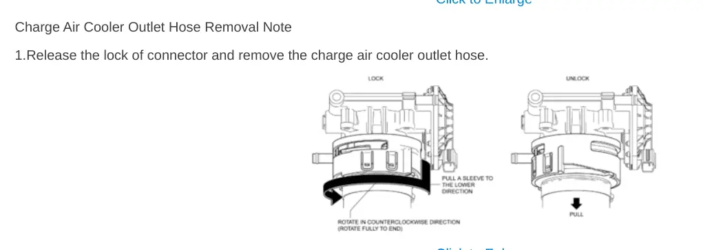

I hope my screenshots of a service manual are not against forum rules, if so please remove:
Removal step:

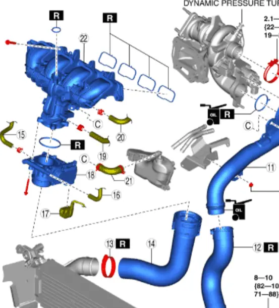

system blown up:

Ninja Edit: Removing that intercooler return collar right before the throttle body and not fully seating it WILL NOT ALLOW THE CAR TO IDLE! I just tried to use the barrymans intake cleaning kit after confirming it comes off the way shown above. I had the curved yellow straw with the kit inside the throttle body and the hard plastic ring 99% of the way on with only a small gap and the CX9 would not idle.
Instead I removed vacuum line #19 above and was able to administer the intake valve cleaning kit that way using their other supplied tool.
Can confirm it works, I just removed it this way! (y)
