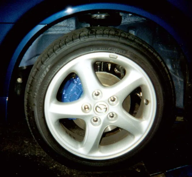

If you've got the tools, do it yourself. It's pretty simple. just make sure you cover everything around the calipers with newspaper and tape, clean your brakes with brake cleaner first, and then use a high temp spray paint. It was about $4 US to buy one can and you only need one. Here's a pic of mine. (The calipers are actually darker, but I think the flash made them look like this. They're closer to the car's color in real life).

My friends told me that it is a pain in the ass to paint them. They have not done them so I dont know if they know what they are talking about, but they say you have to remove them and then bake them to get the paint on and I wont be able to use my car for a few days while they are drying. It sounds like it may not be this complicated at all. It sounds like you guys just paint them on the car and let it sit. Is this how its done?
Todd
Todd, your friends are hitting the pipe a little too hard. You can easliy paint them on the car. I plan on doing mine either later this week or next week. I am going to do it early evening and just let them sit overnight. Probably doesn't take that long, but it won't hurt. I'm also with the high-temp engine paint thing. Sound the easiest to me. I'll let you know when I get mine done, and I'll post some pics as I go through.
