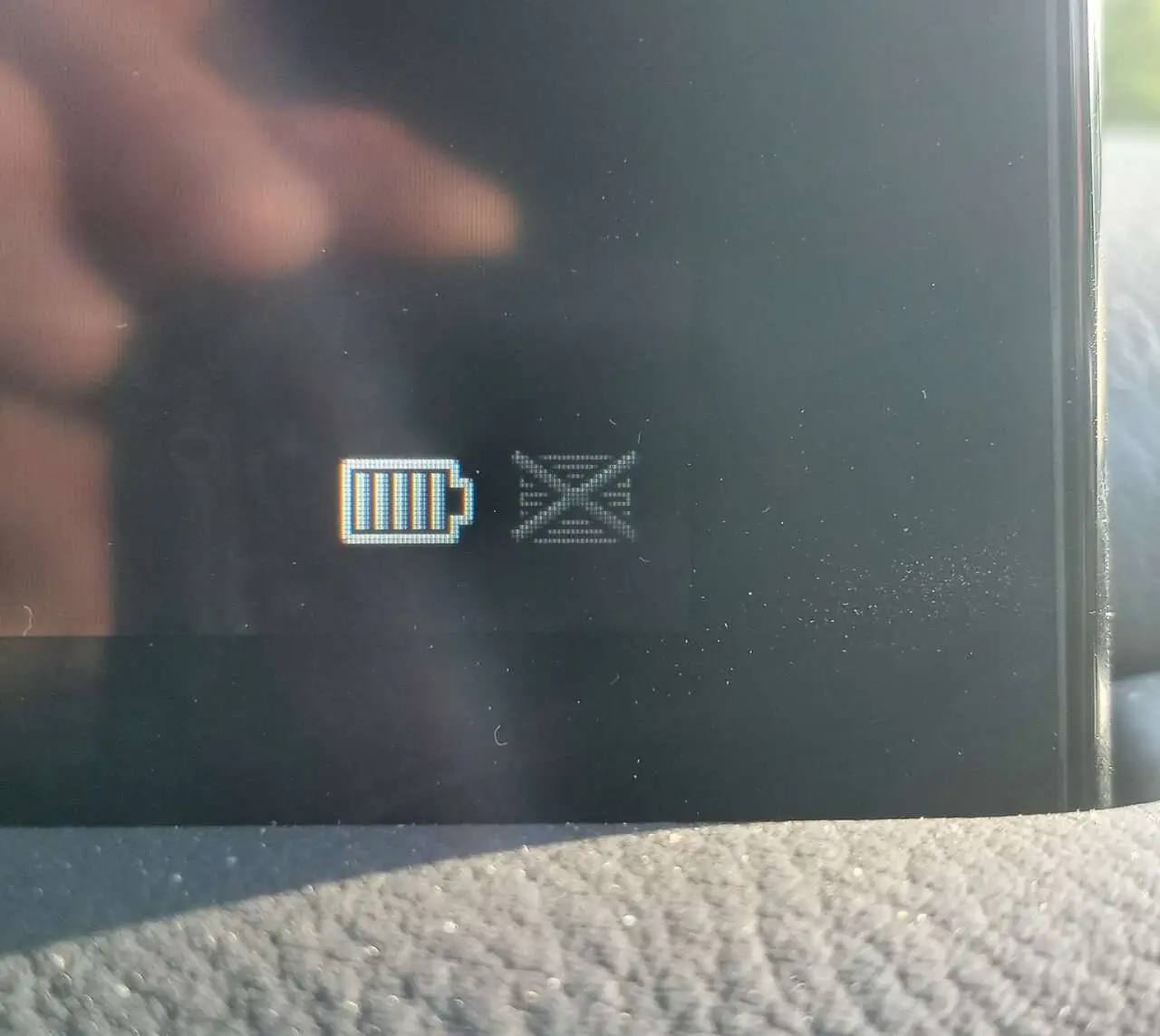

So I called Mazda CEC earlier this week and requested the disable. I was assigned a case number, and the person I spoke with said they sent the signal to my TCU. They also told me to unsubscribe from MyMazda app and uninstall from my phone.
When I got in my CX-5, the signal strength indicator was X'd out. I'm assuming this means the signal disable to my vehicle was successful?

I called Mazda and had them turn off my TCU as soon as I got my brand-new 2024 CX-5 home. Two weeks later I got a phone call from my dealer, informing me there was a recall on my vehicle. I asked for the reason. They said my Mazda Connected Services were not working. I laughed and told them that I had the TCU turned off and that’s the way I wanted it. They seemed to have trouble wrapping their minds around that. I suspect this is likely to come up every time the vehicle goes in for service. Be prepared to remind the service adviser ahead of time that you know the TCU is off and want it to remain off.
I’m not sure that’s the case. Is your cell phone linked to the infotainment system - either with a hard connection or via Bluetooth? I’m pretty sure that’s the phone’s battery indicator and charging status. After I had Mazda turn off my TCU, a little symbol appeared next to these signals, indicating that an attempted firmware update was unsuccessful. The system checks for updates at regular intervals if you have it set that way.
