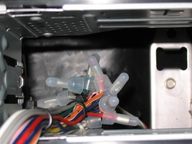

This is a long story so bear with me.
Long time ago my deck got stolen so I went back to the place I bought it from to get a replacement through insurance.
Now that I wanna remove the deck, I realize that they never used a wiring harness, like what I did with the now-stolen deck. Instead they just used these connectors to attach the deck. So now how the hell am I supposed to connect my stock deck back? Do I have to get a stock harness from somewhere, attach it to those wires and then plug it back into the stock deck? I'd rather not use the same method they did. Besides the stock deck should plug right into the harness anyway.
Sounds like a hell lot of trouble...
See pic below....
BTW how do I remove the Scosche 2DIN frame thingy?
Suck man, looks like what you'll have to do is get a reverse-harness. which is essentially what'll plug into the stock deck. And honestly, that is the "proper" way to connect an Aftermarket HU. Generally though they should either leave you your old harnes swith the deck, or leave it intact and simply tie into the wiring.
Umm, actually. is your stock deck's harness connected to your stock deck still?
