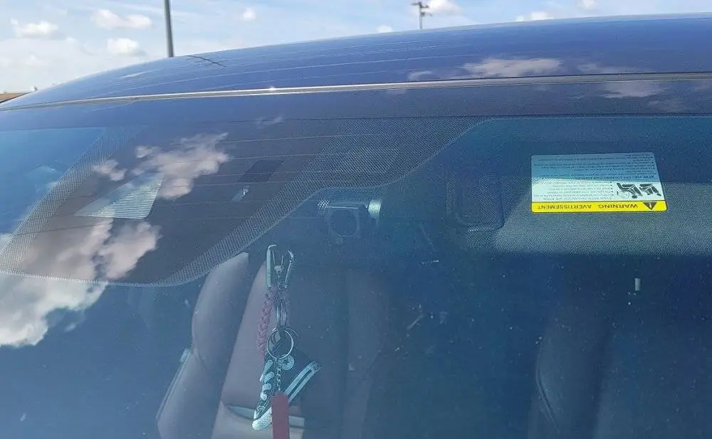

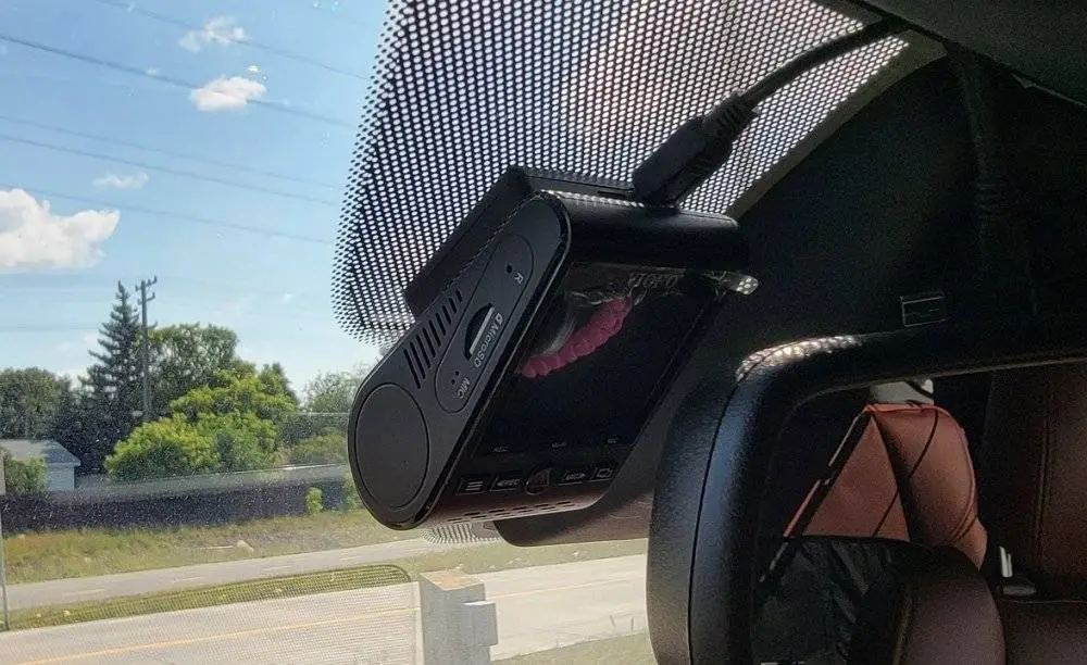

Is it ok for a dash cam adhesive mount to be partially over the frit or should it be below completely? I would like to get the camera as high as possible while keeping the lens below the frit.
yes its ok.
Mine is stuck exactly there (near the mirror) to be as hidden as possible.
I also have mine mounted directly on the frit in my CX-9, mainly to help hide the dashcam mounting point and make it look a little closer to OEM. No issues to report so far and it's been a couple of years since the initial install.
