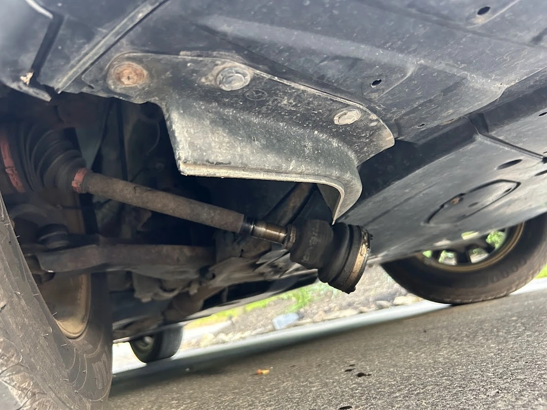

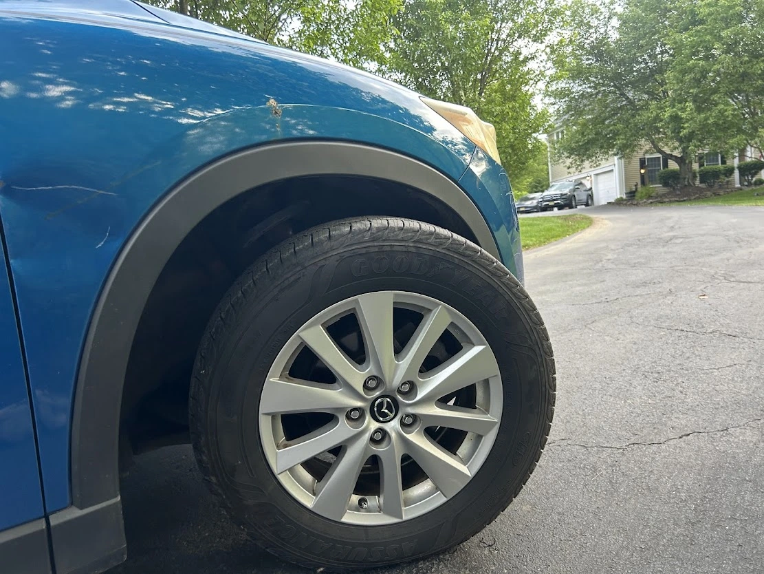

This isn't the first time this has been posted, but I'll share my experience in the hopes that someone else can avoid a similar one.  My daughter sent me pictures of her car (a 2013 CX-5 with 145k miles):
Thankfully, this happened as she was pulling into her friend's driveway and not at speed. The front right ball joint separated from the control arm and pulled apart the axle at the u-joint. A search revealed this is not a new occurrence: Mazda '14 cx5 wheel issue, CX-5 Suspension control arm failure Further search led me to decide to try to tackle the fix: 2013~2016: CX-5 DIY Control Arm Replacement Difficulty?
