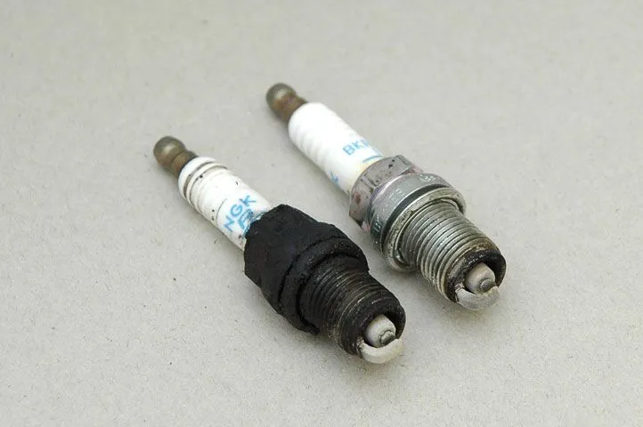

i am losing oil too, about 1000 miles or so, the dipstick will already be at "LOW." if i don't top it off by 5000 miles it will be almost dry. no smoke that i can see of any color. it started occuring around 60k mi. i started changing the oil at 3000 instead of 5000 because it didnt seem to make sense to keep pouring more oil into it for 2000 more miles.
i then had severe case of misfires in #4 cylinder and when i looked at the spark plug i found this:
attachment.php
thats a heavy layer of dried caked on oil. the other spark plugs (right one pictured for reference) were fine but i replaced all 4 including the valve cover gasket. the misfires are gone but when i checked it again recently there was a thin wet oil film on the #4 cylinder spark plug. i can take another picture soon. i suspect if left unchecked the spark plug will end up like the first one above. the new gasket seems to be fine as no other leaks can be found so my theory is there is some sort of leak inside the engine--the valve seals that has been mentioned?
are the valve seals something i can easily inspect and replace? my mechanical skills end at the valve cover if that's any indication i should bring it in to a repair shop. Thanks

That seems more like rings than valve stem seals. I would check compression. Betting cyl 4 has less than the other 3.
But water does not carbon foul the spark plug. He didn't say his antifreeze was low. Oil getting past rings and being burnt in the cylinder with the gas will carbon foul the plug and make oil disappear from the crankcase...poof, dry dipstick if not knowing and paying attention. If you know you are burning oil, you pay attention & give it the oil it wants, fix it or walk.
