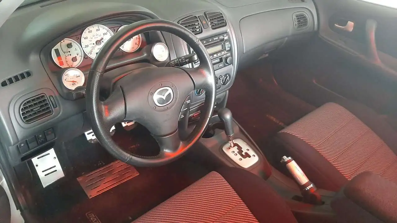

View attachment 315646View attachment 315647
20 years of owning it this year..........ooooo, cheap inspections starting next year, woohoo!
I usually make a fuss of people modifying their automatic cars, but yours looks absolutely sick 😍
