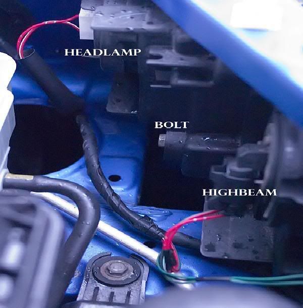

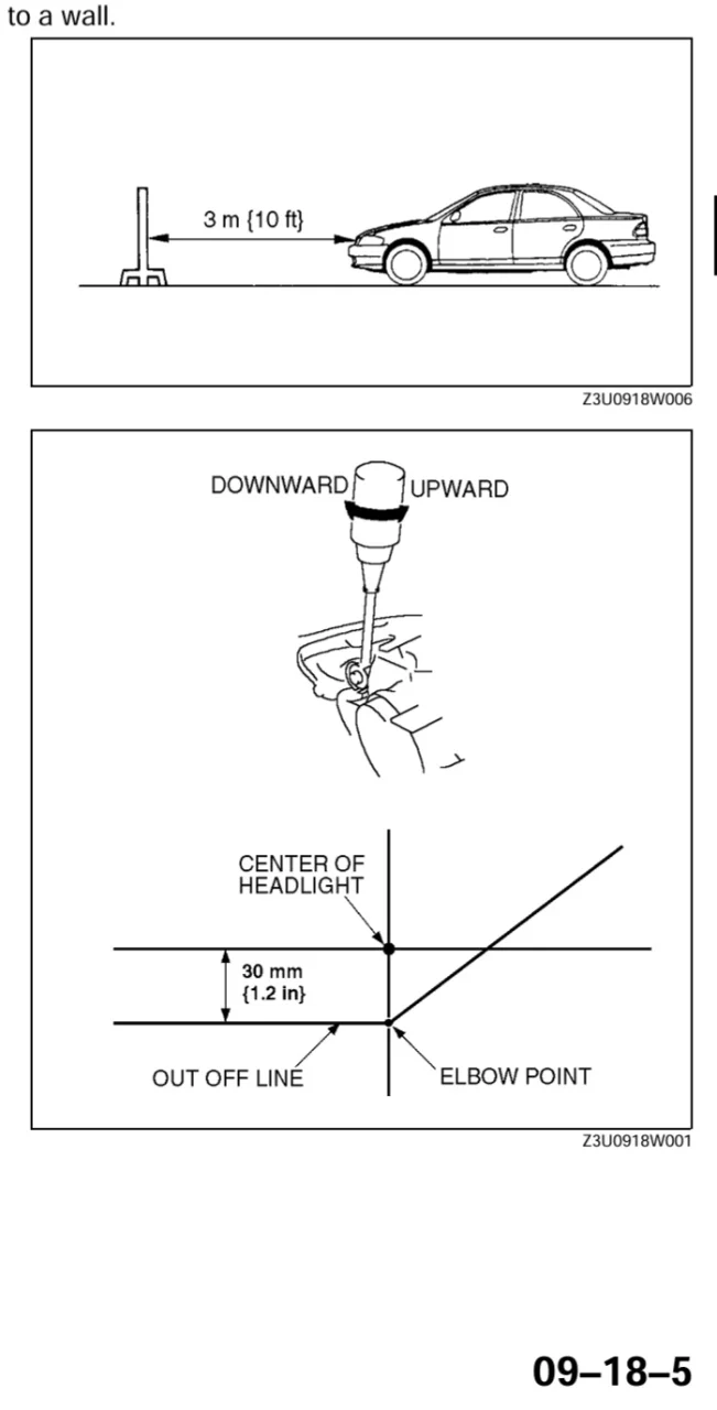

this pic has come in handy many times... and this topic has been covered just as many.
