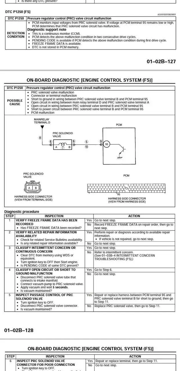

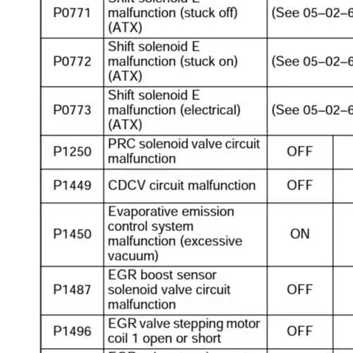

Thank you for that link! I scanned codes but didn't get anything transmission related (only got a p0090 which I believe if fuel pressure regulator)
