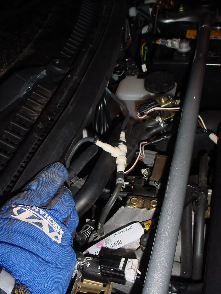

I've also attached pics of the vacuum line "t" connection I used, and the firewall grommet I ran the vac/boost hose through. The above post references the wires to use, it's a bear getting to them (have to remove an underdash panel that pops off at the top and is "hinged" at the bottom) but it's worth it as the boost gauge lighting now dims with the dash lights.

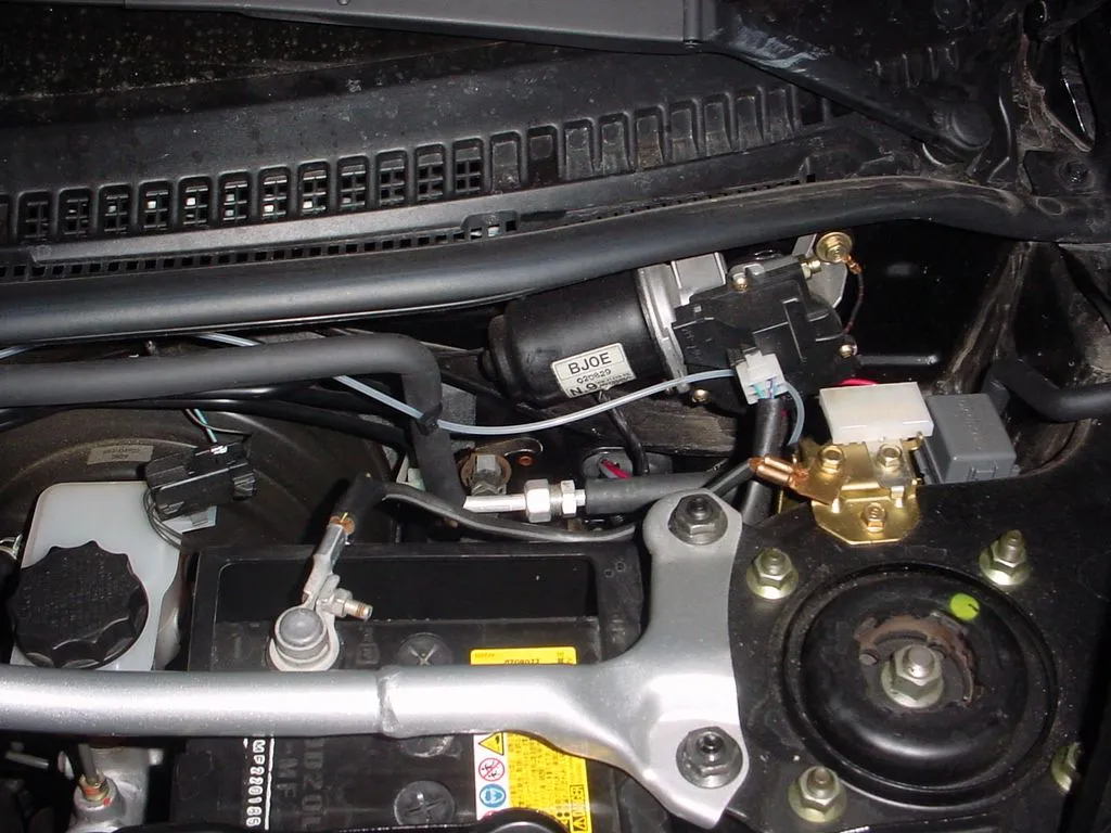

In the firewall pic, liik just beneath the wiper motor - see that white-ish nylon vacuum line? It curls down (don't kink it!) and goes through the grommet just South of the wiper motor along with a red wire I ran so I can eventually hook up my "madeye" MSP and city lights. You'll see a glimpse of the both of them going through the grommet just udner the wiper motor. It's easy to get to that grommet from the inside too (if you're a contortionist and willing to stick your head under the dash a bit).
