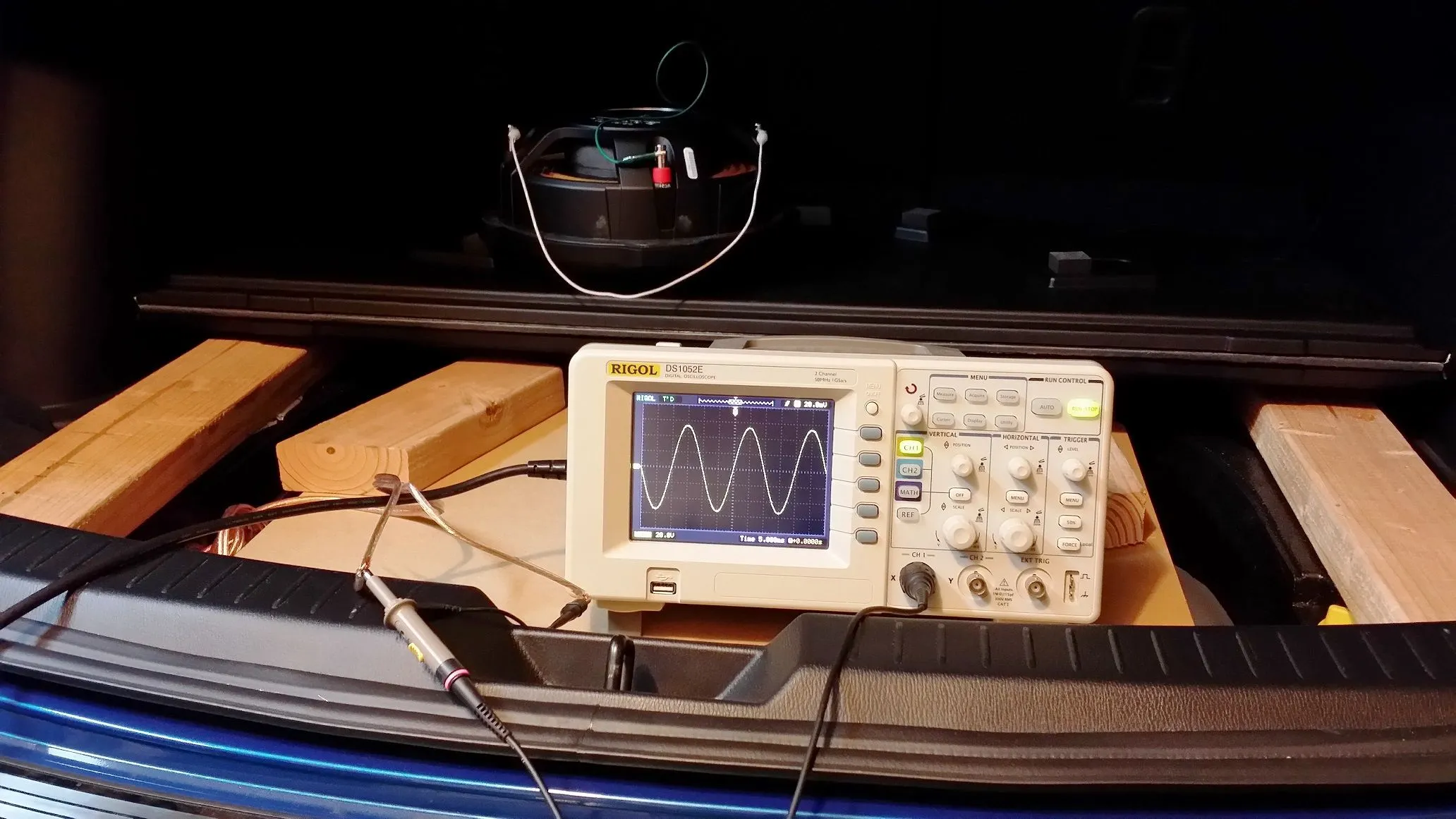

I have even an oscilloscope, to do it right.
I have verified my stereos output, with the scope and a 1Khz signal made by myself on the PC using Audicity. I'm getting, no clipping at the maximum volume of 35. It's an Kenwood Excelon unit, most likely that is why.
I'm not really sure, if that sine wave made by me on my PC, is right or not. Amplitude is 1.
Why I question myself is, because when I hook up the amp to the stereo and look at the speaker output of the amp, I bare open up the gain and it's already starts clipping.
The amp's sensitivity is .250mv to 8V. The Kenwood's output is 5V. In my opinion, I should be able, to adjust the gain somewhere 3/4 of the way, no?
I don't know, how should I adjust the amp, for this calibration.

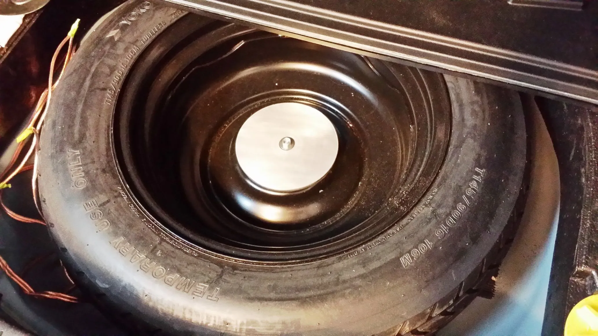

- cut out the MDF to cover my spare wheel and also cut out the hole for the sub. My spare wheel, is the box. No fiberglass.
- cut out a 6" rubber seal and placed it over the wheel holes.
- machined a 6" round aluminum plate, to cover the rubber seal and bolted it down, with a hex head screw for better clearance.
It's all sealed properly, I have even tested it with water and there it was no leak at all.
I have just placed the speaker in the hole, without bolting anything down and it's already hitting hard, with gain at 0, boost at 0.
I need to calibrate the sub amp(I may recheck again the 4 channel amp) and finish up the sub "enclosure".

Always set HU treble, bass eq etc to Flat when adjusting amps. I use a 0db 1kHz test tone for mid range/tweeters and 50hz for Sub. There are many sites with these samples.
I found using an oscilloscope far better then using an rms voltmeter. With no speakers connected to amps connect oscilloscope to output of HU. Crank up the HU volume until it clips. This is the max volume you can ever run your HU. My CX5 HU volume was 47 max. Don't forget oscilloscope measure pk to pk and you want rms voltage.
I would set your pre out voltage to 4.0V as this gives you more volume knob range. A higher voltage means you are getting louder with less volume knob adjustment. I'm using a pac audio line convertor.
Then connect oscilloscope to front speaker outputs (no speakers), turn amp gain right down. Play the 1Khz tone, set HU volume to max from above. Slowly increase the amp gain until you see it clip. You can calculate the rms voltage form the oscilloscope which should be very close to what manual recommends for output voltage. I'm assuming you are bridging the amp to get the full 150w for the fronts (which is what I did on my JL amp). Once you know the voltage and your speaker resistance you should also be able to do a quick calc and confirm you are achieving your 150W.
Then do the same for the sub amp but play the 50Hz tone. Make sure that any remote volume knobs are at max.

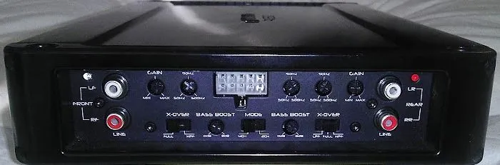

My problem is the little details, like how do I setup the switches and pots on the amps.
How would I set my output voltage, I don't see any adjustments for that. I'm guessing, you can do that, with the Pac adapter, right?

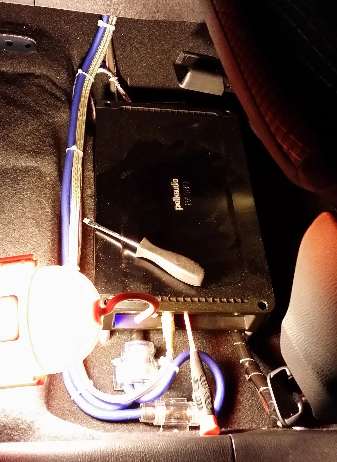

Here is a picture when I was adjusting the four channel amp:
http://www.mazdas247.com/forum/attachment.php?attachmentid=208901&d=1412488388
http://www.mazdas247.com/forum/attachment.php?attachmentid=208794&d=1411879692
http://www.mazdas247.com/forum/attachment.php?attachmentid=208795&d=1411879692
Here is the sub amp installed:
http://www.mazdas247.com/forum/attachment.php?attachmentid=208168&d=1405960171

On the 4xamp set both crossover switches to HPF.
Set the gain pot as per above instructions.
Set the cross over freq to 100hz.
Set the bass boost pot to 0 dB.

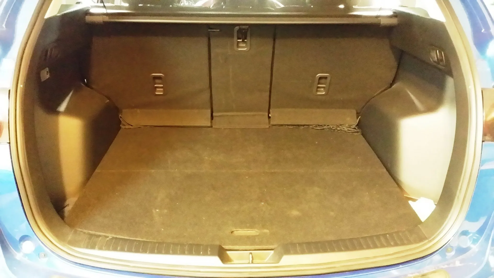

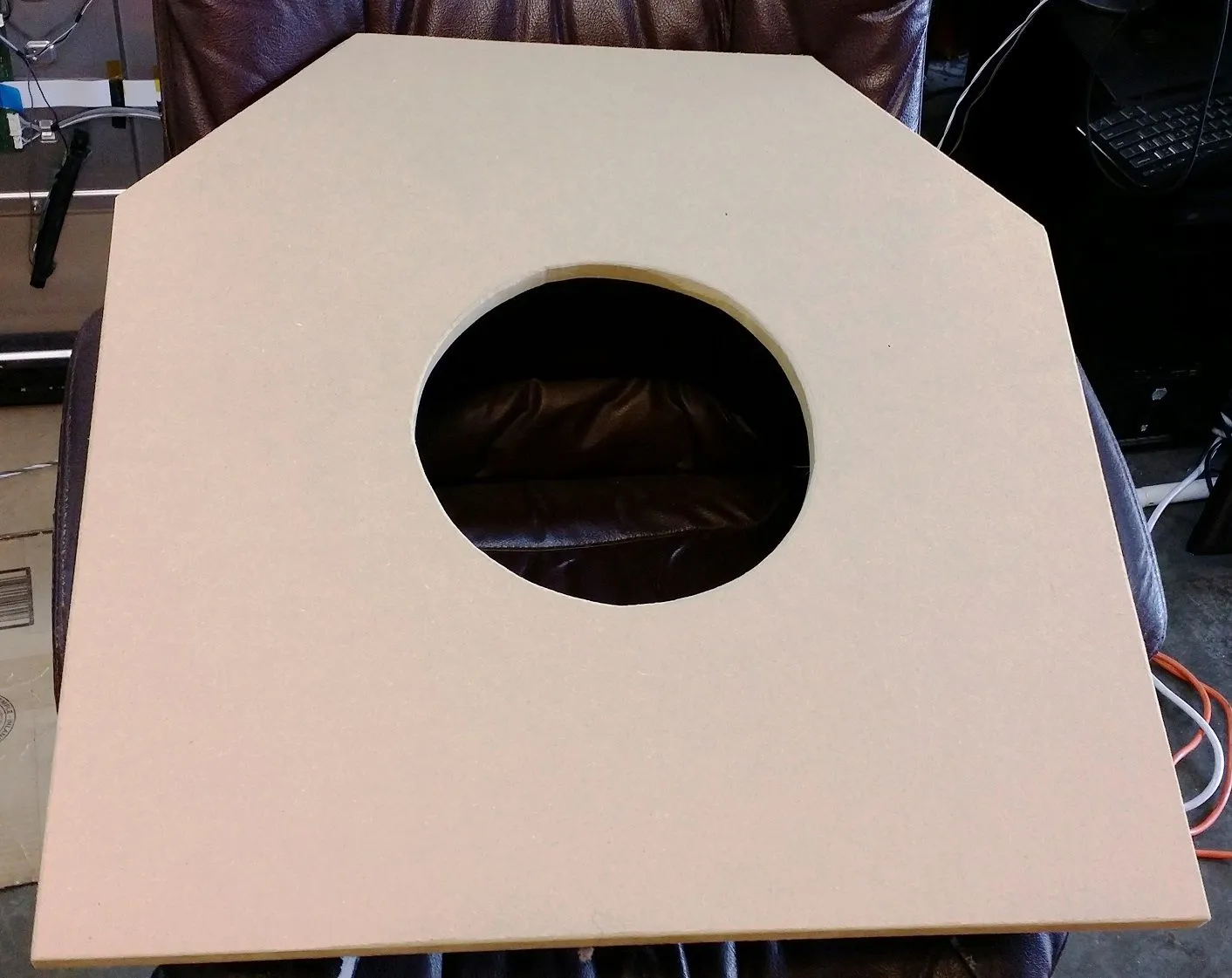

Here are some pictures:

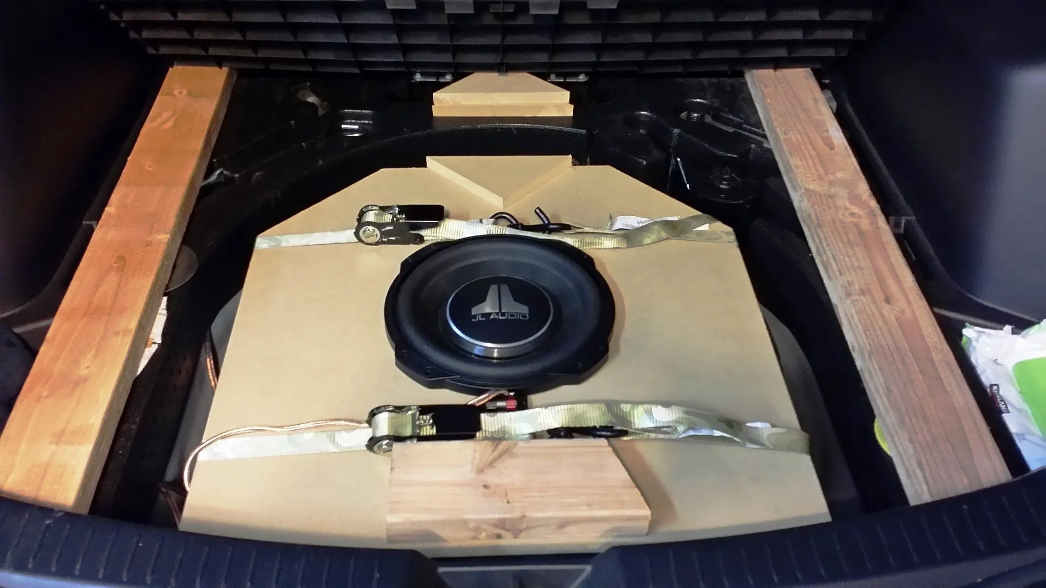

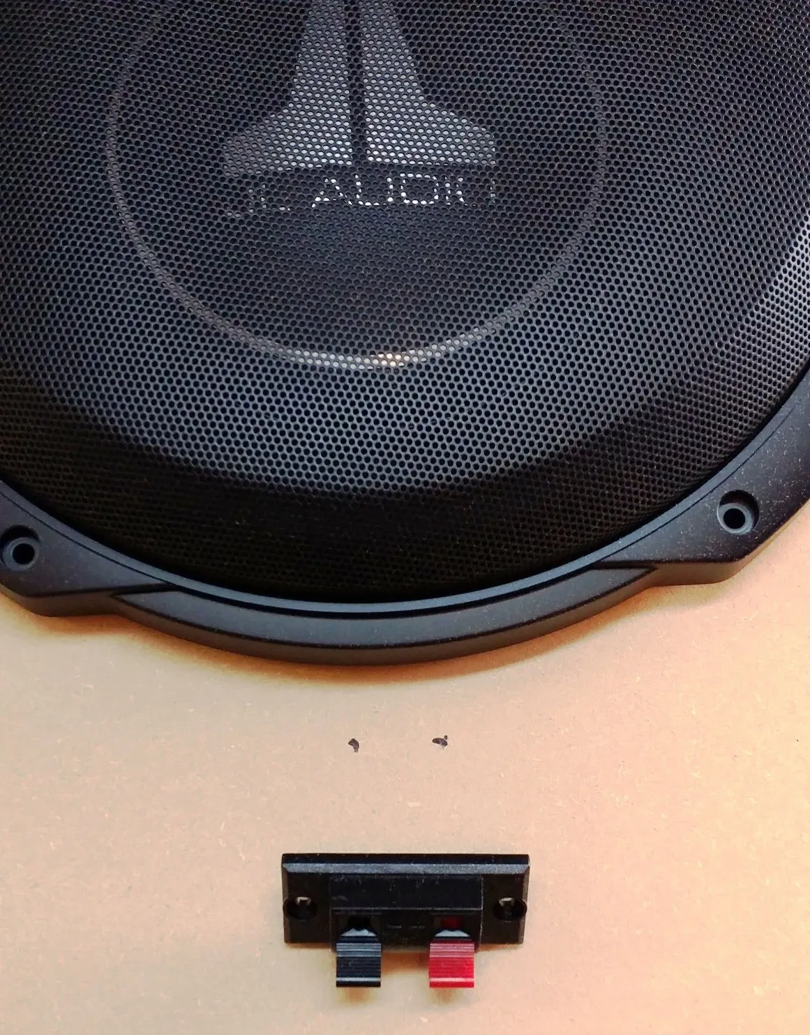

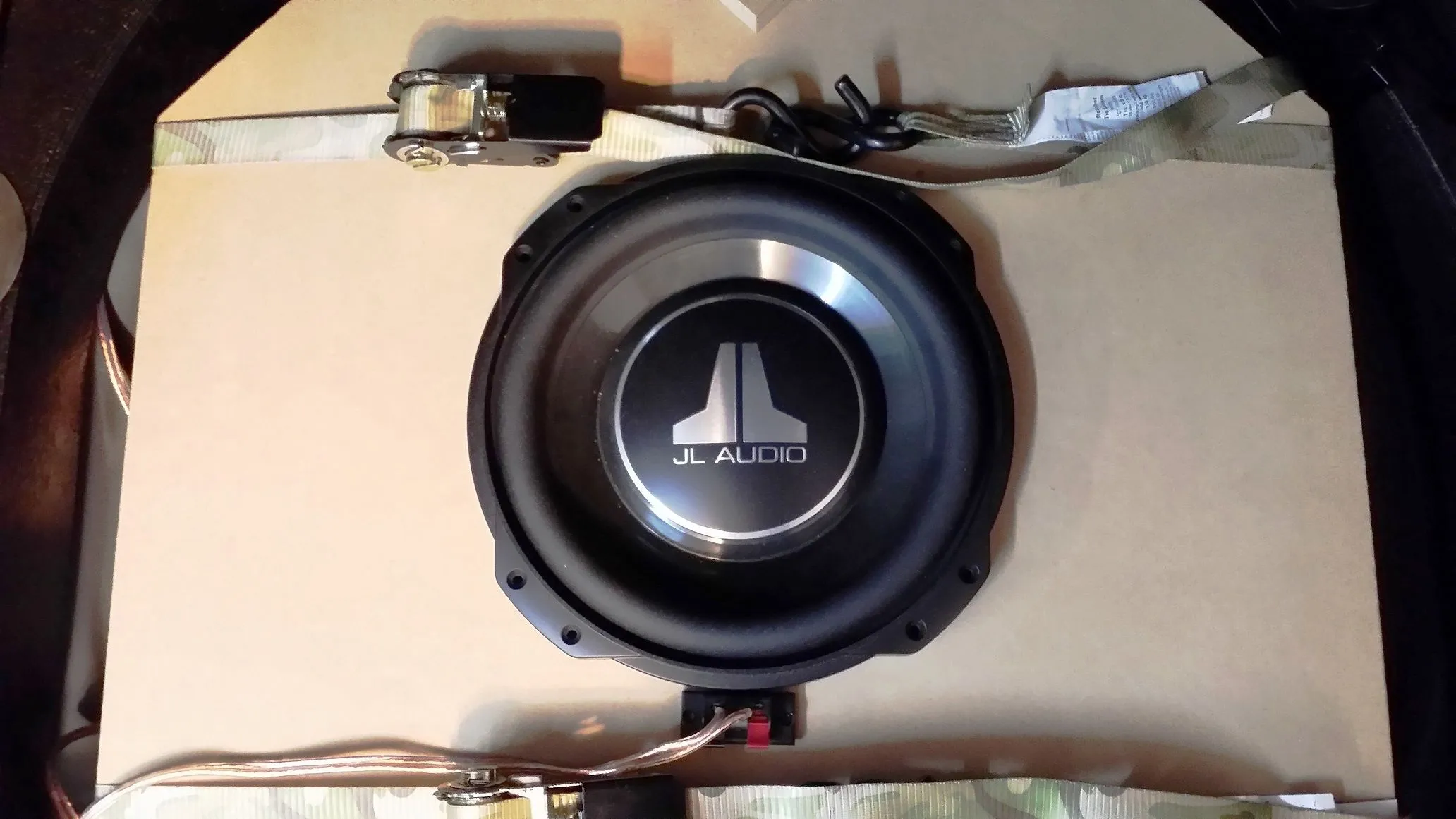

OK, I'm almost done with the sub install.
I need to get some poly-fill and some screws, to install the speaker and wire connector. I may make a rubber gasket for the connector.
In have managed to cut a decent circle with the jigsaw. The speaker is almost tight in that hole.
Soldered all the wires and wire ends.
Used two straps, to tighten the board against the spare wheel.
I still have to cut pieces of 2 x 4 and make a connection between them, to stay in place. I will have to glue some of them, to the board also.
Most likely, tomorrow it will be done.

I gotta say, that looks like an Army job lol, but I know you put a lot of work into it. Good work.
It wasn't a lot of work, just cutting out that board.
This is the only thing that I could do.
I don't want to give up the spare wheel, and I need the trunk area.
Gee you wouldn't even know there is a sub mounted under the floor board. I just wonder though if it would sound better if you made a new floor board with speaker grill in it to help the sub radiate better. I guess when you turn it on see how it sounds covered / uncovered.
Have you done any volume calculations for for the sub and spare wheel to ensure you get the best out of it? Any other sealing between the Tyre and wooden mount?
I did some calculations with water and there is enough space. It's enough up to the lip of the wheel, so up to the top of the tire it's even more room then I need.
It sounds great, no need to change anything. Subfoofer level is at 0 at the stereo, no bass boost at the amp.
The floor is 2" higher now, because I had to add those 2x4s, since the speaker is 2" from the mounting surface to the top of the grill, a bit less without grill. I also have the 3/4" MDF.
There is nothing else between the tire and MDF.
MDF is super smooth and the tire is rubber, there is a very good seal between them. I have tightened it very-very well.
Initially, I had planned to drill some holes in the spare wheel and tap them, then make the same holes in the MDF, then use some threaded rods, which would be between the MDF and the spare wheel. On top use same nuts with washers.
But first, I said to try it out this way and it's working great.
I could add more bass, from the stereo and the amp as well if needed. I don't have the remote knob, but I don't need it anyway. I have set it and I won't adjust it any more.
I won't cover it with hat gray material, because this way it seals better and nobody will see it anyway.
