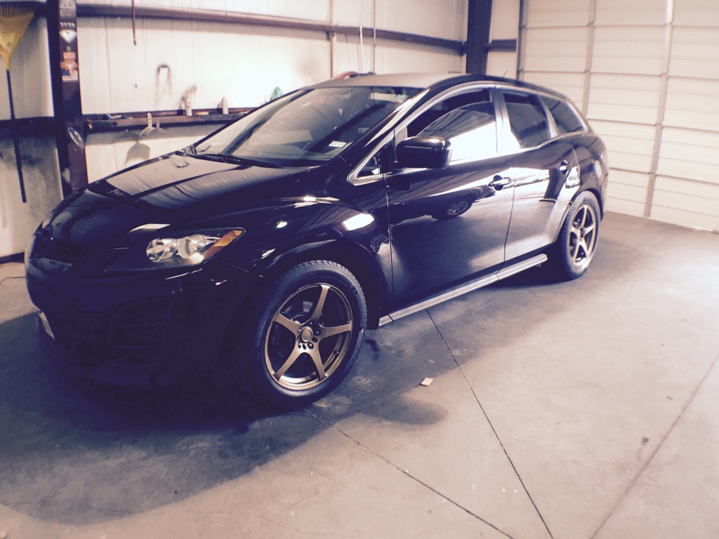

Posting up for speed demon since he's down and out for a while. the cx7 at a local car meet.
Here ya go brian
Pieced together with the help of a team member, Thanks again Andy. The air management is ride pro, the front bags are custom built from a.i.m. ind. I had to send them my stock struts for the conversion. The rear setup uses bags from a chevy s-10 and shocks from a 91 Nissan hardbody. I had to notch the rear sub frame to get it this low. I'm running 2 Viar 480 pumps and a 5 gal tank. I'm also using all metal fitting (plastic ones leak).
Good luck.
Hey Speed do you still have the CX-7 ? Haven't been on for awhile myself, Looks like you went away a few years ago, Hope you are ok, Are you still doing shows?
18x8 wheels, 235/55r18 tires. Factory spring just chopped, handles like its on rails. But I'm gonna have to make some sway bar end links.
