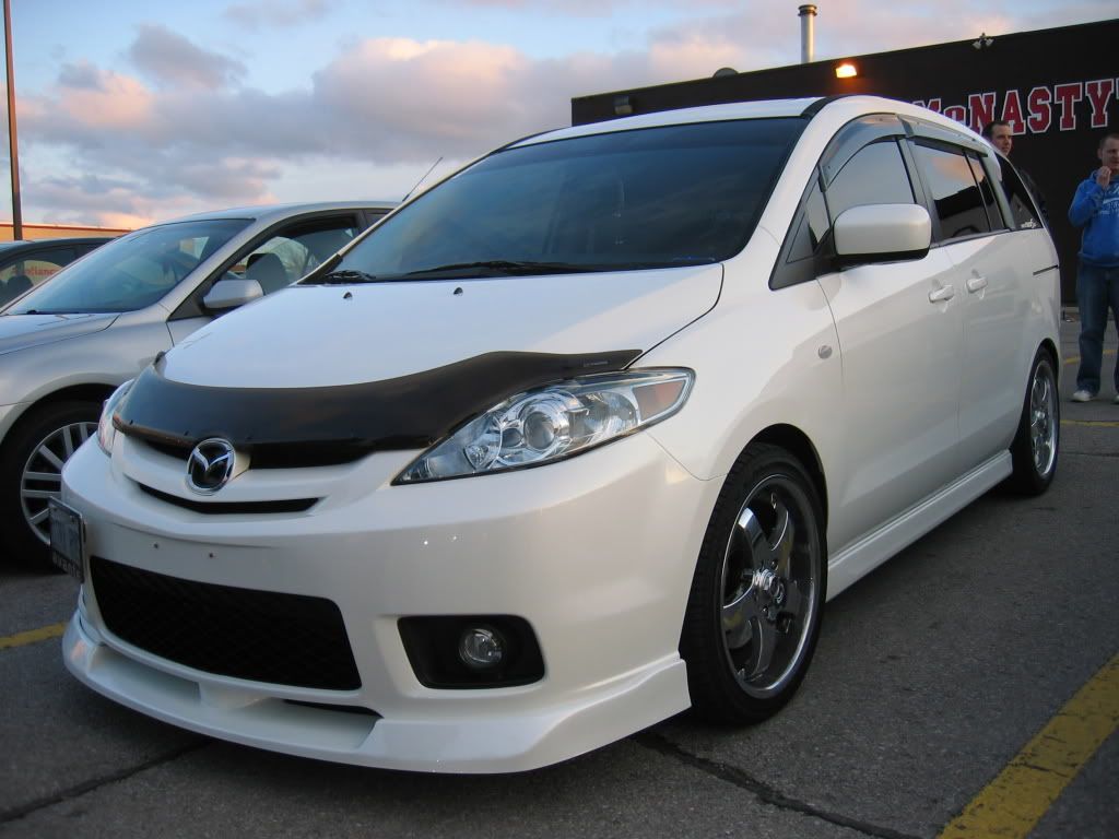

Progress Springs drop
^^Wow that looks low. Can you post up more pics before the camber kit? How bad is the camber? Are you on stock shocks?
I think it loos exactly the same with MS3 springs, the rear sags just as bad. That's why I had to use some rubber inserts to even it out
So I was driving next to a stock MS3 today...I noticed the rear sags on it as well...I just thought it was just because our 5s were so much heavier...but it looked like it did it slightly on the 3 as well....dima, I was looking for the spacers today...the tire shops didn't know, I found a set on ebay...hope they're right...
Here are some better pics
Camber doesnt look too bad but i dont want to find my tires screwed up in a few months so camber kit and alignment will be done asap. Cobb rear sway bar is on as well and its great. Man it handles sooooo much better, but pot holes i used to glide over before i have to slow down for now or try to dodge them cause it hits them hard now.
