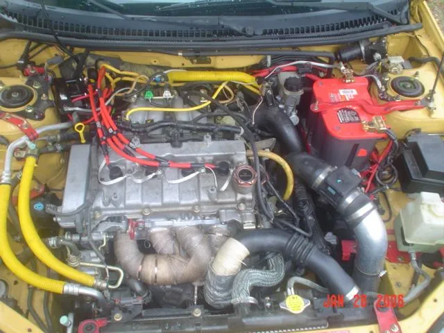

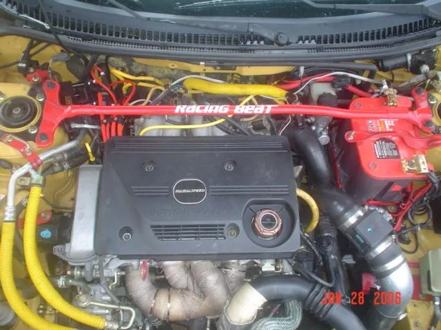

nology wires work fine in the 03.5 no problems until now

Is there any difference between the 03 and the 03.5 setup for these wires? I read the installation for these wires and saw some pics and it showed the coils on the driver's side of the block instead of them being near the firewall on the passenger side. Is that just another place to mount them or is it different for the 03 and the 03.5?
There is a different set up between turbo and N/A applications.
