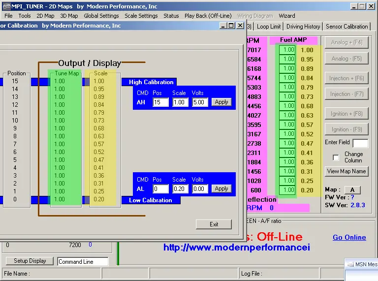

What does the last column in the analog map say? The column that is all alone ( The mutiplier).
If you don't have it, the best map to start out with is chas' map. PM me if you need it.
i have chas' map, nothing worked any better. pats map worked a little better than chas's map actually.

Have you tried raising the multiplier ?
Now that you ask:
Im wondering, in the 1X16 multiplier map, whats the relation between:
the tune (green highlight)?
and the scale (yellow highlight)?
igdrasil said:
Now that you ask:
The way I was explained and don't quote me, it is in relation to load. The green column is the multiplier. Raising that will richen the map overall.
