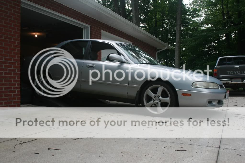

Car up on ramps, oh hell yeah, time for the slammed thread! (spin) Would you believe I haven't washed my car since last November? I think it looks alright considering, lol

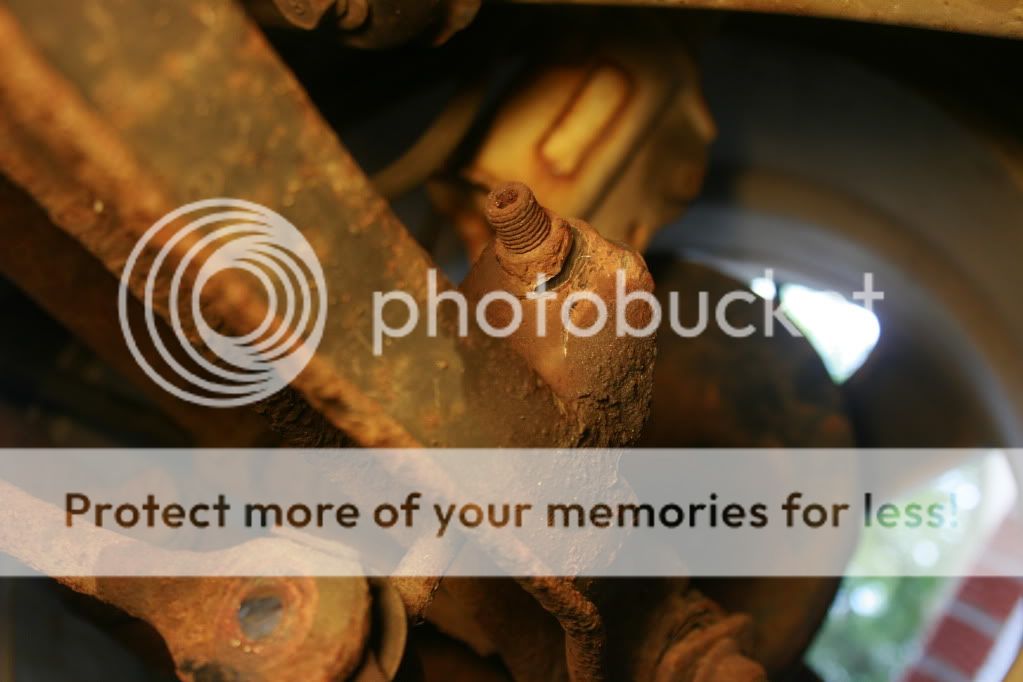

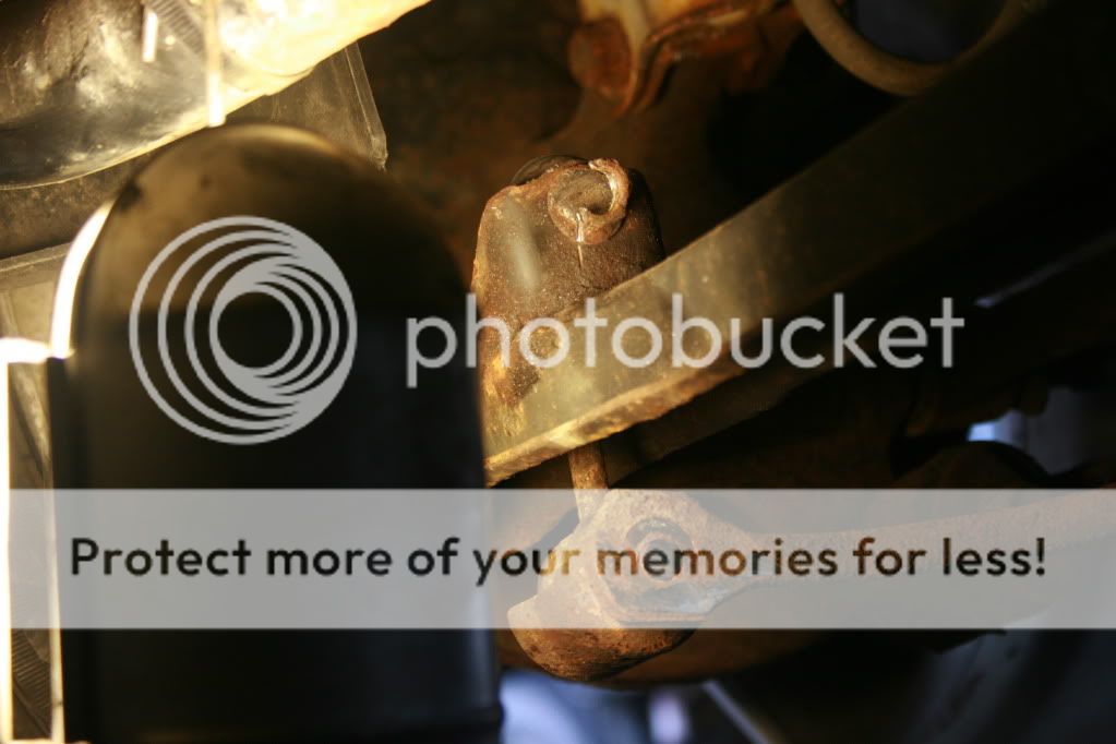

Soaking the bolts in PB (peanut butter blaster, for those in the know), I really should have been doing this for a few weeks instead of 3 mins before I wanted to remove them...
Soaking the bracket and mount

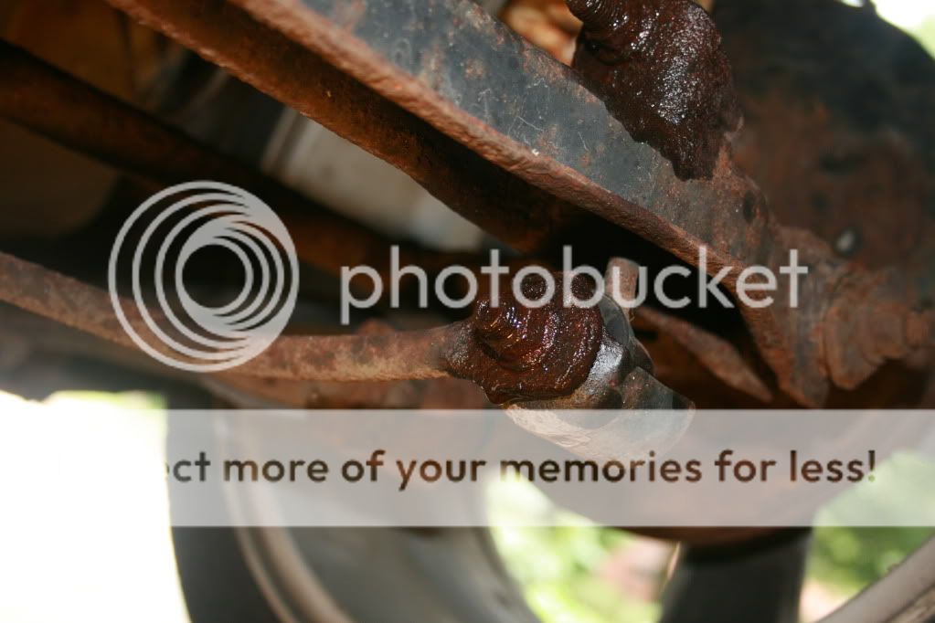

As I'm sure you know, it's basically impossible to ever get end links off, and I planned on cutting mine off anyway, so I'm not sure why I sprayed it with PB :D
Both sides required two cuts, one with the angle grinder which kind of skimmed off the outside of the nut, and then I went back in with the Dremel to cut off the edges of the nut. This pic hopefully explains it better. This side was a pain because there's the tube from the gas tank filler in the way, so I had to also use a Sawzall, but I got it eventually.

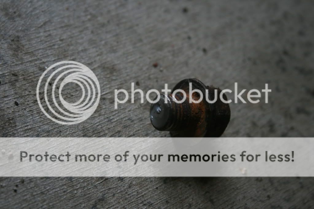

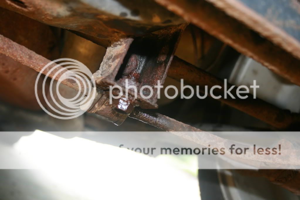

Pack my fudge.. this bolt snapped off. Probably should have soaked it for quite a while instead of just a few minutes before. I guess that's what I get, but I was pretty sad. I thought I was screwed for a quick minute.
I've decided to just cut off the mount and make a new one. There's really no way to get in there to do anything, and the threads are rusty as all get out, so there's a tremendous amount of resistance. Even if I drilled a hole in the bolt and hammered an allen key in there (good luck without a lift...) there's no way I could get enough torque on it to get it out. It was still a struggle to turn the bolt with a 24" breaker bar.
I've seen where the mounts actually tear out of the sub frame, on Civics, or the front on NB Miatas with upgraded bars. I highly doubt that my 17mm bar off a Contour would be thick enough to do that, but I'm going to reenforce the area on the subframe where the new mount will go. I got some 3/16" steel stock, and it's quite a bit thicker than the subframe, so that's my thinking. It's kind of a "Why not, I'm in there anyway" thought. Something I didn't consider until now is that I might not be able to form the 3/16" to the contour I need to fit the subframe. I might get a bit of something smaller, maybe 1/8th to attach directly to the subframe, and then weld the mount onto the beefier patch. I'm going to get some 17mm Energy Suspension poly bushings to finish off this upgrade. I'm not sure what to use yet for a bracket.

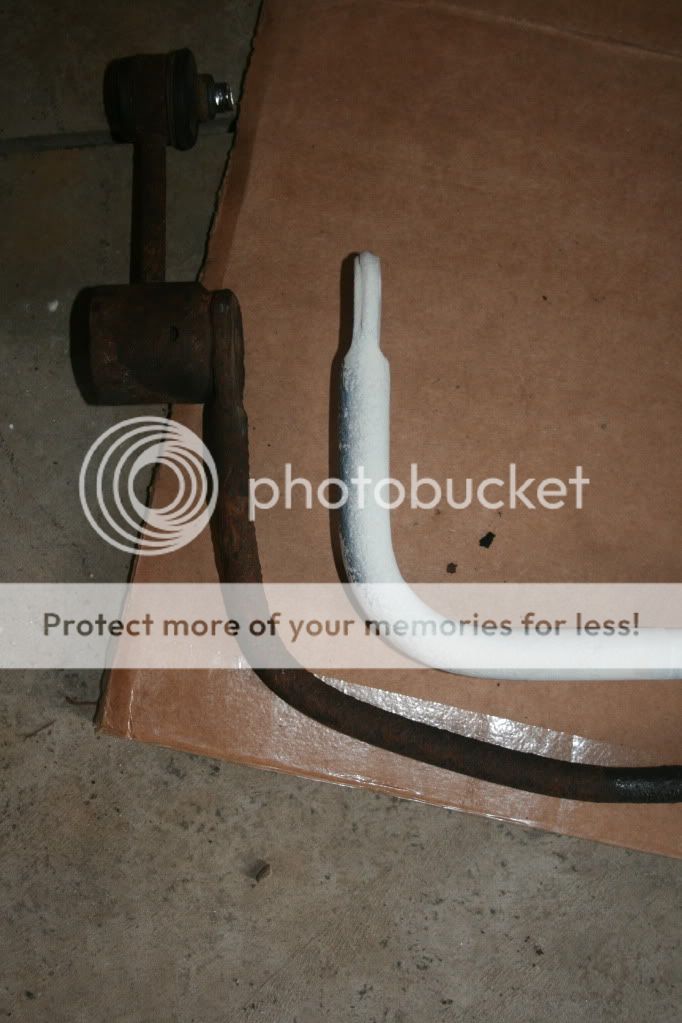

Hmm, guess which one is the new bar.. Hint, I still haven't finished painting it. In all honesty, I've been waiting for it to be less humid so the paint will work right, but every single time I remember, it's been raining. It feels like I'm living on Ferenginar. :P
