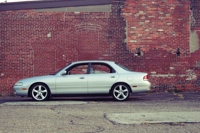

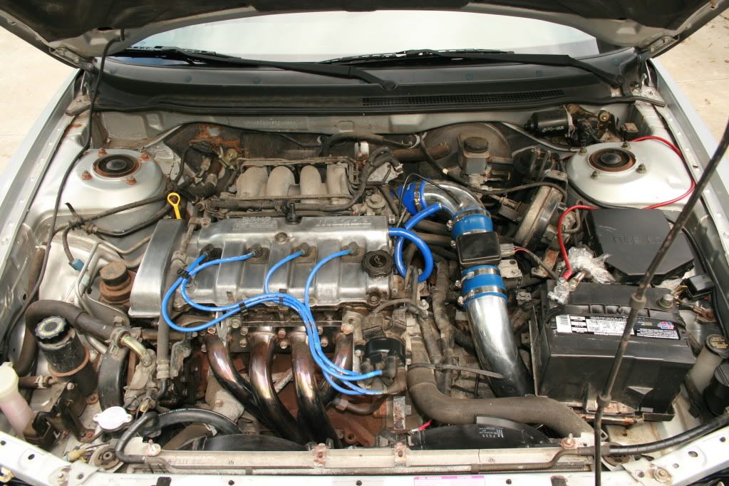

MY 626:
How it sits now:
Already out of date with the motor mounts
Power department:
Ebay CAI
Ebay 4-2-1 "Racing" header
Custom 2.25" piping from cat back
Generic resonator
Magnaflow 2.25" muffler
K6F 88 Duro motor mounts
Handling department:
Tokico Illuminas
Eibach Prokits for a PGT (lowers more than 626 version)
Grip department:
Mazda 6 wheels
Capitol Sport UHP 215/40's
Ichiba spacers, 25mm front, 20mm rear
Bling department:
Heavy = slow, so it's not in the car
Waiting to be installed:
17mm Contour rear sway bar (also need to weld on limiter bushings)
Energy Suspension 17mm greasable sway bar bushings and brackets
Racing Beat RX7 adjustable endlinks
Custom sway bar bushing bracket mounts
TWM short shifter
TWM weighted shift knob
Ordered!
[N/A currently]
Waiting to be ordered:
JDM KL!
